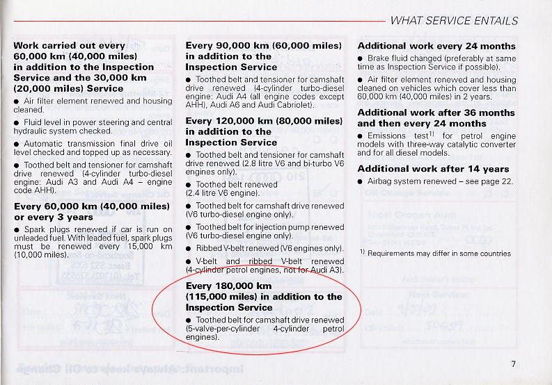

evotista Posted January 30, 2006 Report Share Posted January 30, 2006 You might want to check out my research i did some time ago. LINK Here If yours is a pre facelift officially it is 115k miles or 5 years...however would recommend to do the change at 60-70k particularly if chipped. HTH Link to comment Share on other sites More sharing options...
Jamescalv Posted January 30, 2006 Author Report Share Posted January 30, 2006 Cheers evotista. I got a quote from Volkswerks for £580 which isnt even a main dealer. Yes i'm pretty much convinced that the cambelt is not due until 115k now, althugh i may get it changed earlier. I spoke to the guy at the garage i'm buying the car from who also says its 115k, and he must have got that figure from the service schedule with the car. So does anybody know any key flick codes or button presses to reset the indicator? Link to comment Share on other sites More sharing options...
