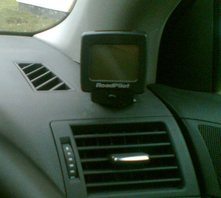

jwo Posted February 1, 2006 Report Share Posted February 1, 2006 Mine is here (see attachement) and hardwired into fuse board Link to comment Share on other sites More sharing options...

Biscuits Posted February 1, 2006 Author Report Share Posted February 1, 2006 Couple of questions if I can. :: How'd you get the cable down the side of the dashboard/A-pillar? :: Where'd you put the GPS reciever? I was thinking of putting under the dash on top of the glove box. :: Where've you put the laserpilot? Cheers Paul. Link to comment Share on other sites More sharing options...
jwo Posted February 1, 2006 Report Share Posted February 1, 2006 if the questions are to me, the cables can be pushed into the gaps around windscreen edge. gps antennae is located ontop of dash infront of central speaker up against windscreen with wires pushed into windscreen gap. with regards to laserpilot - i don't use it, for the simple reason that if it goes off you are 99% caught anyway (and i would rather not know until nip turned up)! i personally would go for a jammer (aka garage door opener) instead. i can send some other pics if needed John Link to comment Share on other sites More sharing options...

Biscuits Posted February 8, 2006 Author Report Share Posted February 8, 2006 [ QUOTE ] Mine is here (see attachement) and hardwired into fuse board [/ QUOTE ] where'd you put the GPS receiver ? I've put the display in the same spot and wired into the fuse board, but would like the GPS receiver hiden under the dash. do you know how to take the vents out of the dash board to get easier access ? Link to comment Share on other sites More sharing options...

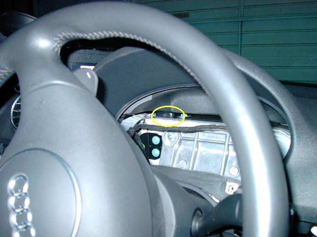

DukeDesmo Posted February 8, 2006 Report Share Posted February 8, 2006 I originally had mine on the dash but recently moved it underneath, I tried getting to the front of the screen but there's no easy access due to a huge alloy crossmember, so I took out the Instrument panel (2 screws) and put the receiver between the crossmember and dash top - perfect fit tight enough not to need any sticky stuff and works fine. This is on an A3, don't know if other models are the same. Link to comment Share on other sites More sharing options...

DukeDesmo Posted February 8, 2006 Report Share Posted February 8, 2006 Well, taking the clocks out was easy, 2 screws only and the wire's long enough to not have to disconnect and everything worked OK afterwards. Link to comment Share on other sites More sharing options...
