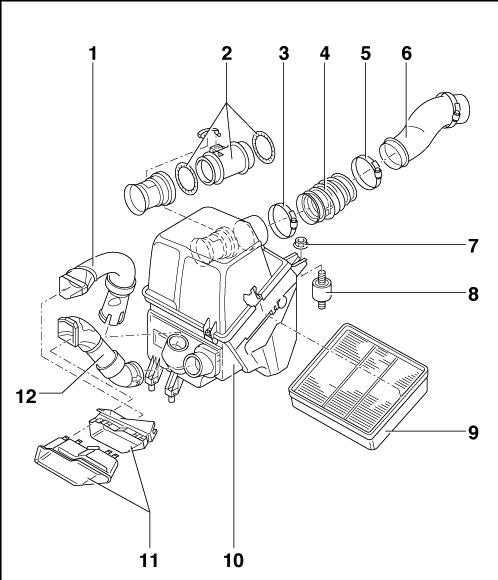

FuntimeFrankie Posted May 6, 2006 Author Report Share Posted May 6, 2006 Remembering that I'm a muppet at anything mechanical, I don't even know where the MAF is, let alone clean the thing! You couldn't take the time to explain for me could you? Quote Link to comment Share on other sites More sharing options...
cruiser647 Posted May 6, 2006 Report Share Posted May 6, 2006 The MAF is inside a protective plastic tube (about the size of a toilet paper tube). This sits in the lid of the airbox. Take that off, and then use cotton wool bud to gently clean the thin metal strip that you will see through the meshing. It is VERY fragile and VERY easy to break. Tools, only Crosshead screw driver to undo teh Jubilee clip holding the air pipes on. Hope that helps. Good luck! Quote Link to comment Share on other sites More sharing options...
Ska Posted May 6, 2006 Report Share Posted May 6, 2006 the maf sensor is in item no. 2 in the diagram. Its a very thin wire essentially and you need to be very careful when cleaning its with either alcohol or electric contact cleaner using a cotoon swab etc. once you have cleaned the maf and if the prob doesn't go away you might wanna consider looking at the coil packs. Quote Link to comment Share on other sites More sharing options...
SneakyMcC Posted May 6, 2006 Report Share Posted May 6, 2006 [ QUOTE ] Remembering that I'm a muppet at anything mechanical, I don't even know where the MAF is, let alone clean the thing! You couldn't take the time to explain for me could you? [/ QUOTE ] Some here? Quote Link to comment Share on other sites More sharing options...

FuntimeFrankie Posted May 7, 2006 Author Report Share Posted May 7, 2006 Quote Link to comment Share on other sites More sharing options...
FuntimeFrankie Posted May 13, 2006 Author Report Share Posted May 13, 2006 Thanks everybody for the assistance Due to the mesh being very fine on the 'tube', was unable to get a cotton-bud to one side of the MAF sensor, so that side I sprayed a little carb cleaner on it, and allowed to dry. Now working fine Quote Link to comment Share on other sites More sharing options...
