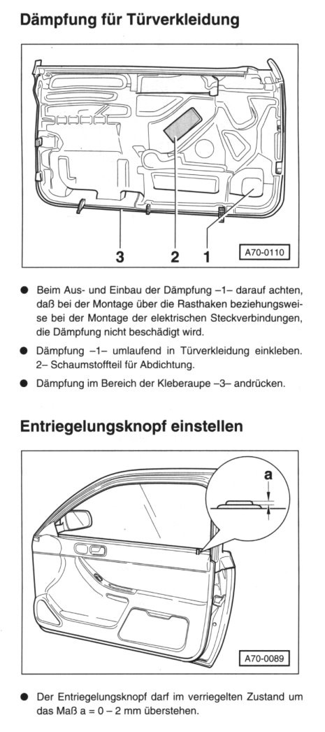

Blaa Posted August 19, 2003 Report Share Posted August 19, 2003 This might help you, only problem is that it's in german. Quote Link to comment Share on other sites More sharing options...

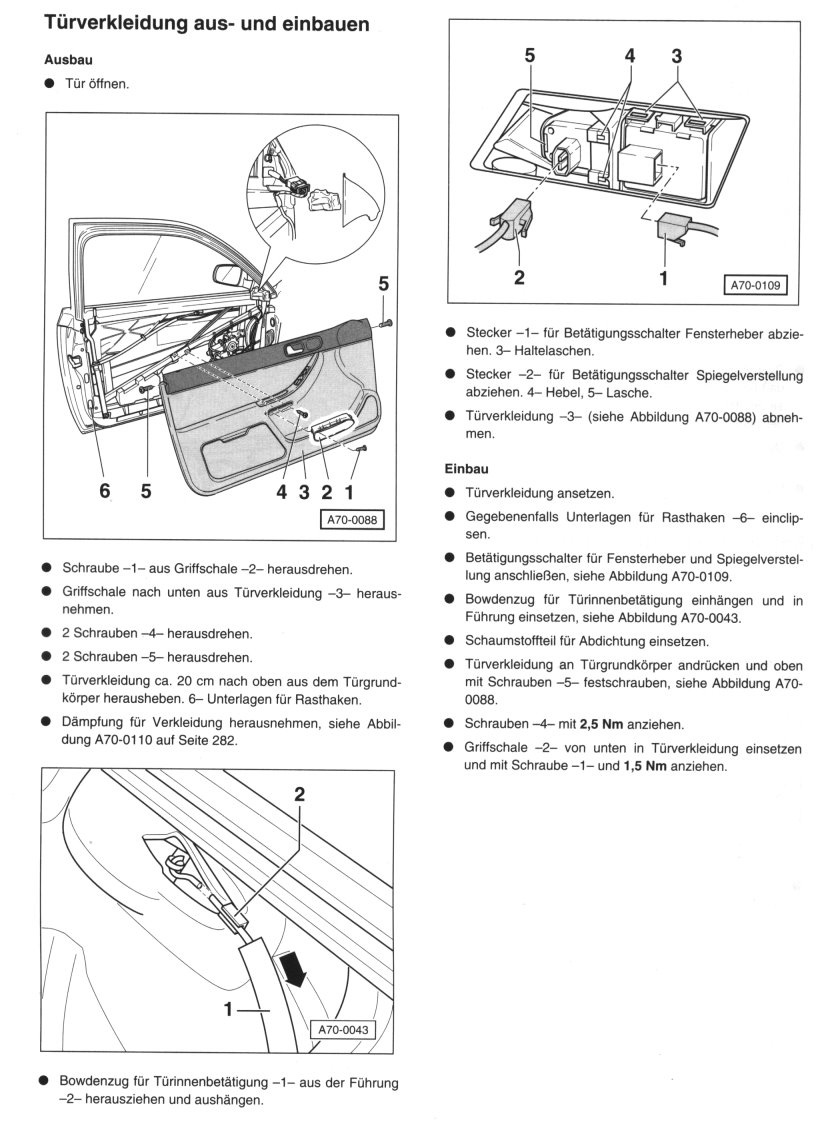

Blaa Posted August 19, 2003 Report Share Posted August 19, 2003 And the rest. Quote Link to comment Share on other sites More sharing options...
bpsmith Posted August 20, 2003 Author Report Share Posted August 20, 2003 Thanks for the diagrams, but does anyone have these in English or can translate them for me as my German is not that good? Quote Link to comment Share on other sites More sharing options...
ACarlton Posted August 20, 2003 Report Share Posted August 20, 2003 It depends on the year of your car as they changed the panel slightly. If it is the same one as the pictures above then here goes. Remove the 2 screws at the top corners Under the pull to close handle there is a small screw that holds a cover in place behind this cover is either 1 or 2 screws some models have a screw towards the bottom of the panel in the little cubby hole pop the panel off its clips all round, this is best done with fingers rather than a screwdriver etc once the panel is off you will need to release the bowden cable (shown in the bottom picture above) and the electrical connectors Good luck :crazy Quote Link to comment Share on other sites More sharing options...
