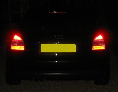

Paul Posted July 29, 2006 Report Share Posted July 29, 2006 I have always been annoyed by the fact the S3 only has one rear foglight on the rear offside (drivers side) and the passenger side does nothing/remains empty. It either looks cheap, or you got a bulb out. Well, ive gone for the symmetrical look and retro fitted/enabled the other side. The passenger light cluster itself has the bulb holder, tracks and everything in place, just no pin/wiring/feed in the harness plug to power it. Having managed to get hold of a pin for the harness, it was just a matter of: 1.Taking a feed off the working foglight, 2.Fitting the pin in the plug, 3.Removing the break out blank in the light cluster so the bulb can fit in. 4.Fitting a second foglight bulb Result gives a much cleaner symmetrical look. The added safety, of double the fog light output so you can be seen more easily in fog. Does not upset the bulb out warnings. (I dont think the fog light circuit is checked by this anyway) Simple mod with the correct bits, maybe infrequently used, but i am happier in the knowledge that its done. 1 Quote Link to comment Share on other sites More sharing options...

Paul Posted July 29, 2006 Author Report Share Posted July 29, 2006 Quick pic with the double fog Mod. Quote Link to comment Share on other sites More sharing options...
