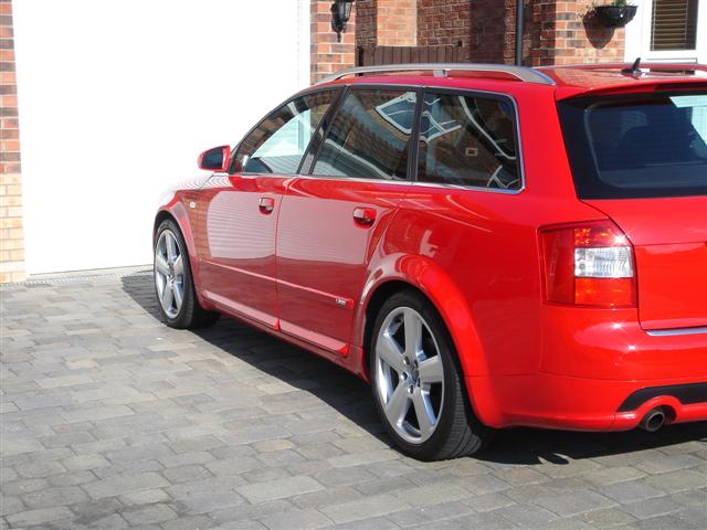

copster Posted August 18, 2006 Report Share Posted August 18, 2006 I'm also thinking of upgrading from my 18" DTM wheels to some 19" (type yet to be decided.....) Problem is like Milo i don't really want to get into lowering the car (yet!) Is the A4 gonna look like a 4x4 without lowering though - anybody running 19's without lowering and have any pics?? Quote Link to comment Share on other sites More sharing options...
P_G Posted August 18, 2006 Report Share Posted August 18, 2006 Mine rides on 19's but the S4's run slightly lower than A4 anyway, but to give you an example Quote Link to comment Share on other sites More sharing options...
