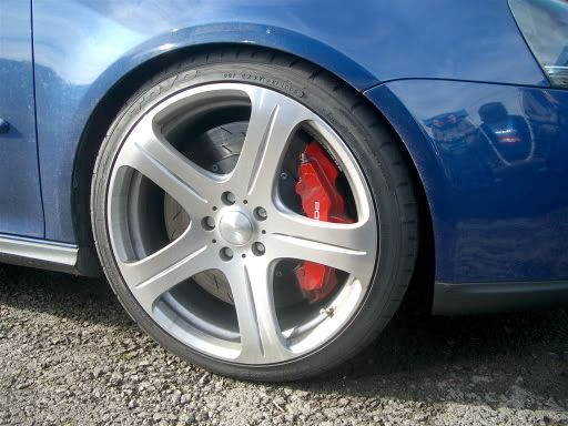

RedRobin Posted September 14, 2006 Report Share Posted September 14, 2006 Photobucket up 'n running again, so pics as promised: Link to comment Share on other sites More sharing options...

Oli Posted September 14, 2006 Report Share Posted September 14, 2006 [ QUOTE ] [image]http://i22.photobucket.com/albums/b308/RedRobin_05/West_GTI. [/ QUOTE ] Thats Tims car from South Coast Wheels(now in liquidation unfortunately), as the Plate suggests - T1M VW, it is 270BHP by the way Link to comment Share on other sites More sharing options...
RedRobin Posted September 14, 2006 Report Share Posted September 14, 2006 ....I know - I've driven it (when I took the pics). It's tuned by Ray West. Link to comment Share on other sites More sharing options...
