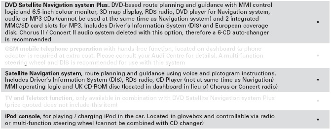

Sparky Posted September 15, 2006 Report Share Posted September 15, 2006 A friend is currently spec'ing up a new A3 and has opted for the CD based sat nav with glove box mounted ipod console, but Audi are saying this isn't compatible. Is there anyway to have the iPod adaptor and the CD based Sat-Nav? Seems a bit restrictive. It appears OK if he upgrades to the DVD-based SatNav, but this adds nearly another £800. Can anyone suggest anything here? He doesn't really want to shell out for the DVD system as it takes him over his allowance (company car). Cheers for any assistance. Link to comment Share on other sites More sharing options...

craigyb Posted September 15, 2006 Report Share Posted September 15, 2006 Is it perhaps because there is no room. Only one CD changer slot? I guess, not knowing how the new system is configured that you could always add the Ipod interface at a later date as a lead and not as a cradle. If the the HU supports the CD changer interface you can add an audi lead for £100 for the ipod. But I would need to check the wiring diagrams Link to comment Share on other sites More sharing options...
Sparky Posted September 15, 2006 Author Report Share Posted September 15, 2006 It's making it sound like there is no input on the CD-based SatNav unit. I've attached the spec list to see if it helps you as we're not certain what it means. Any ideas? Link to comment Share on other sites More sharing options...
