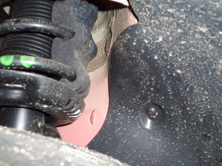

Trefor Posted November 23, 2006 Report Share Posted November 23, 2006 I thought the suspension of our 400 mile old Golf GTI felt a bit firm. Being the naturally suspicious type I had a shufty in the wheel arches. Look what I found (attached) Link to comment Share on other sites More sharing options...
SamD Posted November 23, 2006 Report Share Posted November 23, 2006 That is terrible and surely dangerous! Link to comment Share on other sites More sharing options...
MOSE Posted November 23, 2006 Report Share Posted November 23, 2006 THat is absolutely appalling and utter negligence from the dealer. If it were mine, I would be demanding a new car and if they refused I would send all the major car press a copy of that photograph to prove a point. Link to comment Share on other sites More sharing options...
Tarmac_Terrorist Posted November 23, 2006 Report Share Posted November 23, 2006 Unacceptable! Was anything on the PDI actually done or did they just sign the paperwork? That's got to be worth a free service in compensation. Link to comment Share on other sites More sharing options...
danksy Posted November 23, 2006 Report Share Posted November 23, 2006 I would demand some compensation What else did they miss on the PDI Link to comment Share on other sites More sharing options...
Trefor Posted November 23, 2006 Author Report Share Posted November 23, 2006 I sat there for a few minutes looking and thinking "nah, they can't have". Good to see VW dealers on par with Audi dealers. Our car had an extra 2 weeks waiting for us to collect it at the dealers for a proper PDI. Instead we got a bird poo damaged bonnet (polished it out myself) and this. Link to comment Share on other sites More sharing options...
MOSE Posted November 23, 2006 Report Share Posted November 23, 2006 Demand a new un mate and GO PUBLIC!!! Just my view of course!! Been down this route before with BMW, but NEVER again! Link to comment Share on other sites More sharing options...
TwoSheds Posted November 23, 2006 Report Share Posted November 23, 2006 Has happened on quite a few occasions in as much as people have been adding it to listings, on forums, as something to check when picking up the car apart from the usual things. Or noticing problems with ride comfort later. It would be better if they were made in bright colour so they stood out more. Still no excuse for leaving them in at PDI. Link to comment Share on other sites More sharing options...
nutkins Posted November 23, 2006 Report Share Posted November 23, 2006 Isn't this quite common? Evo magazines test car had them left in and they didn't find out until the first service. I'm sure I've read about it a few times. Link to comment Share on other sites More sharing options...
Maxyboy Posted November 23, 2006 Report Share Posted November 23, 2006 i can see its something that stops the spring from compressing but what actually is it? Link to comment Share on other sites More sharing options...
nutkins Posted November 23, 2006 Report Share Posted November 23, 2006 [ QUOTE ] i can see its something that stops the spring from compressing but what actually is it? [/ QUOTE ] Aren't they just exactly that? Keep everything stable while it's being transported on the Ferry etc? Link to comment Share on other sites More sharing options...
MOSE Posted November 23, 2006 Report Share Posted November 23, 2006 SO it isnt just a cheap gizmo to make the suspension on the GTi feel a bit more sporty?? Link to comment Share on other sites More sharing options...

Trefor Posted November 24, 2006 Author Report Share Posted November 24, 2006 [ QUOTE ] Isn't this quite common? Evo magazines test car had them left in and they didn't find out until the first service. I'm sure I've read about it a few times. [/ QUOTE ] So if its quite common why don't they know and check? Link to comment Share on other sites More sharing options...

Trefor Posted November 24, 2006 Author Report Share Posted November 24, 2006 They called me first thing and are collecting the car at 3pm to sort it out. Name and shame, no, but if you happen to look at my profile and see where I live you may guess where we bought from. Link to comment Share on other sites More sharing options...

Snoopy Posted November 24, 2006 Report Share Posted November 24, 2006 [ QUOTE ] [ QUOTE ] i can see its something that stops the spring from compressing but what actually is it? [/ QUOTE ] Aren't they just exactly that? Keep everything stable while it's being transported on the Ferry etc? [/ QUOTE ] Yes, There to stop the car bouncing about on the ferry but more important on the car transporters. Watch cars on the back of recovery trucks to see how much they move without them. These help reduce that a great amount. They can also sometimes make the car higher too to help loading and unloading from transporters etc. These been left in is VERY common on many makes. Its shoddy PDIs quite often happens at peak times of the year at reg change when dealers are very busy. You would probably be amazed how often this happens. Link to comment Share on other sites More sharing options...
