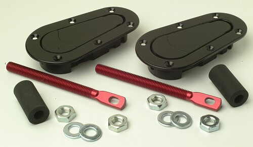

Ritey Posted December 15, 2006 Report Share Posted December 15, 2006 Having a carbon fibre front end on the mini I would suggest that when and if you fitted a bonnet to a golf, you wouldn't hinge it, just 4 points of contact in each corner. I also wouldn't use panel pins either unless it was a track car, you can infact get lockable bonnet clips that use a similar key to a bike d-lock that fit flush and spread the lift weight across a big washer under the bonnet. Much more secure than pins There are cheap versions of these though which I would seriously avoid having experienced them myself Quote Link to comment Share on other sites More sharing options...

Dan32 Posted December 15, 2006 Report Share Posted December 15, 2006 [ QUOTE ] Where the hell is that pic on Google when you want to find it of the yellow RS4 with a carbon fibre bonnet that let go at whatever the speed was and smashed the windscreen. It's been photo'd in the garage afterwards. That's enough to either put you off carbon fibre bonnets or to persuade you to get proper fixings for it... [/ QUOTE ] Thats the photo I've seen and was referring to as well. There are some nice looking latches floating about, think they're called Aerocatch. Aerocatch website Quote Link to comment Share on other sites More sharing options...
