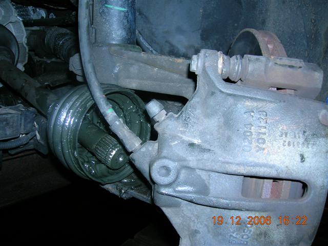

Chelsea Mick Posted December 19, 2006 Author Report Share Posted December 19, 2006 Well it looks as though it might turn out alright in the end. Have spoken to my buyer and the ST has been in the garage. It appears that the work I had done by my local garage to replace the nearside cv boot gaiter, they used the wrong retaining clip and the drive shaft popped out when it went round a right hand corner. It's looking very hopeful that the drive shaft, allthough slightly damaged, will be popped back into place using the correct retaining clip. Shouldn't cost my buyer anymore than the price of the clip and some labour. Got some photos to show to my local garage and the opinion of the mechanic at my buyers garage to see what they have to say.. Thanks for all your comments guys Quote Link to comment Share on other sites More sharing options...
Ian_C Posted December 19, 2006 Report Share Posted December 19, 2006 How on earth can a driveshaft pop out whilst driving? You have to take the front upright off to get the driveshaft out, surely?? Ian Quote Link to comment Share on other sites More sharing options...
Chelsea Mick Posted December 20, 2006 Author Report Share Posted December 20, 2006 Ian The drive shaft popped out on the nearside the end closest to the road wheel. There is a groove around the drive shaft that retaining clip sits in. There is also a groove on the inside of the wheel hub where the drive shaft is situated. Now if this clip is the wrong type (which is true in this case), when you turn the steering on full lock to the right, this will put strain on the cv joint. As the retaining clip was the wrong type it didn't hold the drive shaft in the hub correctly. Here is the drive shaft out of the hub. Quote Link to comment Share on other sites More sharing options...

cruiser647 Posted December 20, 2006 Report Share Posted December 20, 2006 Good news! Your buyer shoould be happy, especially as it was the garage that fecked it up! Quote Link to comment Share on other sites More sharing options...
