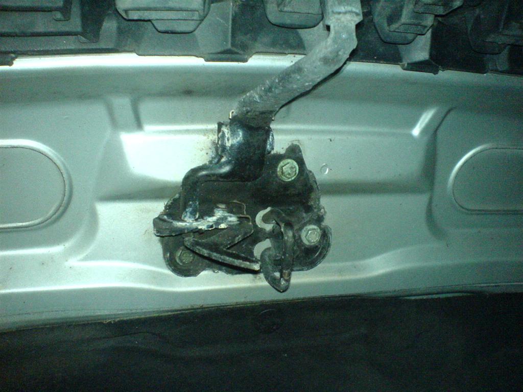

Henke Posted January 24, 2007 Report Share Posted January 24, 2007 Hi, I've a flat battery in my B5 yr 2000 A4 1.8T quattro so obviously I need to get at the battery but when I try to pull the lever under the steering column, nothing happens. The lever itself seems fine and I think the problem is at the actual latch at the front of the bonnet. I've taken off the grill and can move the lever (which usually pops out through the grill when the inside lever is pulled) but nothing happens. Its virtually impossible to see the latch mechanism looking up through the grill opening. Perhaps someone is familiar which this latch and what I'd need to get at to open it? Anyone ever have a problem like this or perhaps offer any advice? I really want to exhaust all options before having to call the dealership to get this sorted. Cheers! In fact, even if someone with a B5 audi A4 (99/2000) could take a photo of the mechanism/latch under the bonnet and post it, I'd appreciate it Link to comment Share on other sites More sharing options...
J_C Posted January 24, 2007 Report Share Posted January 24, 2007 I have a B5 A4. It's in a partially lit underground garage at the moment, but I'll go and have a go at getting some decent pics and post them up ASAP. Link to comment Share on other sites More sharing options...
J_C Posted January 24, 2007 Report Share Posted January 24, 2007 OK, not great quality but maybe they will help. Catch mechanism: Close up: Bonnet catch: Good luck! Link to comment Share on other sites More sharing options...
Henke Posted January 24, 2007 Author Report Share Posted January 24, 2007 Thats brilliant mate, thanks! I was about to head into the local Audi garage there to ask if I could have a look at a B5 A4, they'd have probably charged me for that!! At the very least you've saved me that trip in anyway! Link to comment Share on other sites More sharing options...

kite Posted January 25, 2007 Report Share Posted January 25, 2007 JC, you have not cleaned your bonnet catch Link to comment Share on other sites More sharing options...
J_C Posted January 25, 2007 Report Share Posted January 25, 2007 I've hardly cleaned any of it. Believe it or not, I can count the number of times that car has been washed since I bought it in June on one hand! It needs doing properly, inside and out and top to bottom. That'll be my summer 'project', after I've finished the S4. Link to comment Share on other sites More sharing options...

aerotec Posted September 4, 2009 Report Share Posted September 4, 2009 Just registered and thought I should add my comments as I just had this problem. My 2000 A4 would pop to the safety latch but the bonnet release catch was seized. To get the bonnet open I gently removed the chrome trim around the front grille. It has clips on the inner side so gently prize the outer egde with your fingers till it all comes away. Then remove the front grille by pulling the top out. You may need to use a flat head screwdriver to help with this so use some card so as to not damage the bonnet. It will eventually pop out and the catches that hold it in shouldn't be damaged. If you see where the catches are you can push them down as you pull the grille forward, that might help. The bottom of the grille does not pop out, you lift the grill up and out once the top comes free. Then you can easily see up to the catch, spay it with WD40 or release agent and it will eventually loosen up. Then just grease up the mechanism so it won't happen again. Link to comment Share on other sites More sharing options...
