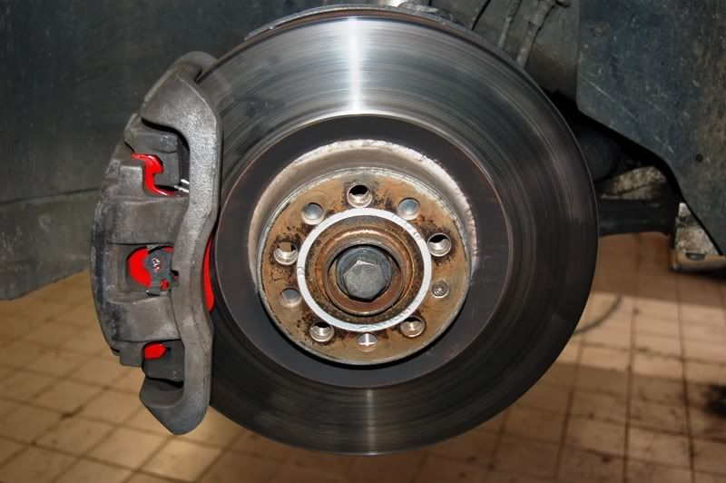

JaminBen Posted March 6, 2007 Report Share Posted March 6, 2007 Well well well...: After a few short days, the lovely package arrived at my doorstep : Service over the internet and telephone was first rate (thanks again Walter!), but sadly the rear pads referenced are an incorrect size: Per ETKA, 3.2L A3s use the following pads: front 1K0 698 151b, and rear 1K0 698 451b. If someone could confirm that the MkV R32 uses the same ones, it would help everyone here – though I’m 99.99% sure they are identical. I called PureMotorSports, and Walter put the correct rear pads in the mail. Should be here within 5 work days. Sadly, PureMS is not willing to foot the shipment costs, which is quite unaceptable: I ordered the set they said I would need and so they should have covered the costs of their mistake. Regardless, we pushed on with the front pads. They were a direct replacement, and went in like feet in well-worn slippers: A quick bleed of the system, and off I went to bed the new front pads in. 6 or 7 fast stops from 100 to 40 got them hot and smelly, but not burning: I've seen 400 degrees Celcius on the track, so this isn't too much... The disc did turn instantly blue; quite a nice color, and should match the R32's calipers reasonably well: I then I settled in with a copy of Evo (en Francais! - MUCH better in Shakespear’s tongue by the way) for the obligatory cool-down period. 30 minutes later I was on the road again: well waddya know? These things BITE!!! My OEM pads were still fresh, but these things just grip the rotor like baby’s mouth on momma’s t*ts! I am well impressed, and can’t wait to receive the rear pads. I did try stupid-hard braking in a turn to see just by how much balance was askew, but was surprised to find balance was still OK. Our cars are so front-heavy that we could just as well do with no rear brakes at all ;-) Next weekend I hope to attend a track day: we’ll see how they fare with REAL abuse. Stay tuned… Quote Link to comment Share on other sites More sharing options...
