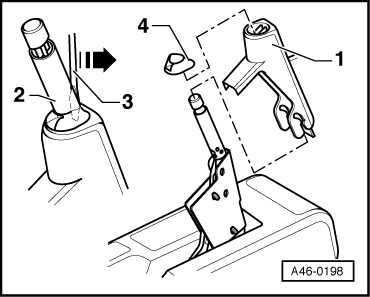

Quattrophenia Posted March 15, 2007 Report Share Posted March 15, 2007 I recently saw a posting (on Audi DIY I think) that had photos and instructions on how to change the handbrake lever/handle on an A4/S4/RS4 but can't for the life of me find the posting again. Anybody any ideas on where this might be - has anyone else seen this? Link to comment Share on other sites More sharing options...
harddrive Posted March 15, 2007 Report Share Posted March 15, 2007 Don't know about the post but this is what the manual says: Release handle -1- with a screwdriver -3- and pull off handle Pull off cover -4- and handle -1-. Hope this helps Link to comment Share on other sites More sharing options...

Quattrophenia Posted March 15, 2007 Author Report Share Posted March 15, 2007 Great - yes it does help... cheers Link to comment Share on other sites More sharing options...
