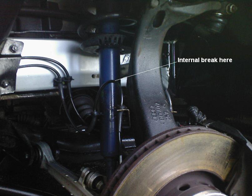

Ska Posted March 17, 2007 Report Share Posted March 17, 2007 Ah yes, that'll be one or more of your ABS/ speed sensors at the front if its happening on turning. It breaks internally where it loops between the suspension and the hub due to a life of err turning the wheel. Fix is either replace at £90+vat each (they are push fit easy job). Or remove and take out the offending break and resolder (which is what I did). Sometimes if you have a lot of crap on the wire it does this too as I found out when my CV boot exploded sending grease all over it so it stutered sort off on moving off. see pic Or it could just be dirt on the sensor itself (proly not as its only doing it on turning) but theres more on Audipages Link to comment Share on other sites More sharing options...

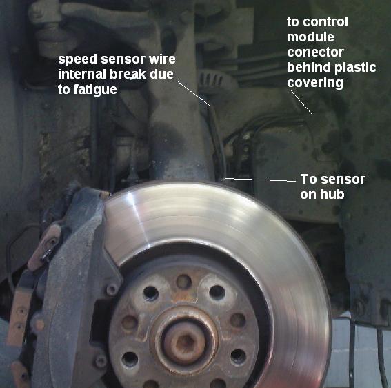

Ska Posted March 18, 2007 Report Share Posted March 18, 2007 I dont know about the tyre scrub as mines fwd but it may have something to do with the traction control if not the ABS as that must use the speed sensor too. The symptom is very distinctive and happens at crawl speed (just moving off and/or turning); its as if you've dabbed at the stop pedal under ABS opperation for a second, tyre scrub wouldn't impede the cars forward motion as much, this litterally stops it for a second. The light does not come on always You can see where it normally breaks more clearly from this pic... Link to comment Share on other sites More sharing options...
