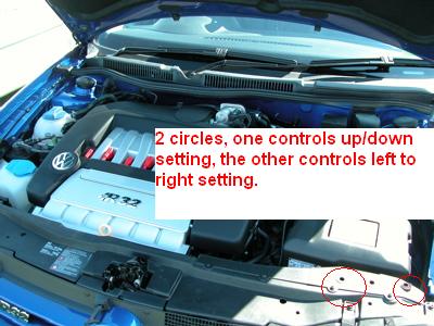

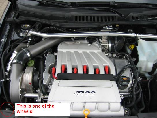

dubzter Posted March 22, 2007 Author Report Share Posted March 22, 2007 [ QUOTE ] [ QUOTE ] alright Martyn, how's you? Anyway not a bad job apart from cutting myself on the broken glass, 2 hours with a couple of coffee breaks and a second refit of the bumper because I forgot to tuck the under tray in. Next question how do I get the light to level out, I thought it was automatic? [/ QUOTE ] Level it out manually. Park the car facing a clean white wall (garage door for example), preferably when it's dark outside. Lift the bonnet, and adjust the new headlamp using a phillips screwdriver by turning the white wheels on either side of the headlamp. one wheel does the vertical movement, the other wheel does the horizontal movement. You dont need vagcom to do that, and vagcom won't do that either. Vagcom part is only for setting the base level setting to allow the car to know how to compensate for heavy loads [/ QUOTE ] Don't suppose you have a photo of the adjustment wheels? or could you describe where they are a bit more Link to comment Share on other sites More sharing options...

Gti_Fly Posted March 22, 2007 Report Share Posted March 22, 2007 Sorry could not find a better pic in the gallery.. BUT I have circled ONE of the adjustment wheels for you. The other one will be easily visable when you lift the bonnet! You stick a screwdriver in, and turn the wheel gently until you think you have the beam pattern in the correct place. Link to comment Share on other sites More sharing options...
Gti_Fly Posted March 22, 2007 Report Share Posted March 22, 2007 Ok, so I have circled where the adjustment screws are in this pic. You can access them by sticking a phillips screwdriver in, and turning them. Have a look down the holes, u will see a white cross headed screw which allows u to adjust the beam angle. Link to comment Share on other sites More sharing options...
Gti_Fly Posted March 22, 2007 Report Share Posted March 22, 2007 Ok, so there you have both sides.. Sorry I dont remember which side you have fitted.. obviously you only need to adjust the settings for the NEW headlamp!!! Do it when it's dark, and adjust the new headlamp so the beam pattern is the SAME HEIGHT as the other original headlamp. The left to right setting is gonna take a few goes.. you have to try and align the triangle cut off so it matches the other headlamp.. all will be obvious when u drive down a dark road. the triangle beam patterns should match up, creating a powerful cut off on the nearside.. To light up the kerb side! Link to comment Share on other sites More sharing options...
dubzter Posted March 22, 2007 Author Report Share Posted March 22, 2007 nice one mate, i checked when I got home and they are pretty obvious when you see them, don't know how I missed them last night. Link to comment Share on other sites More sharing options...
