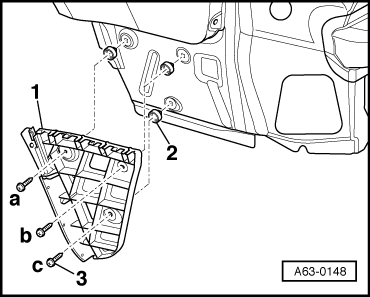

nickbell Posted April 7, 2007 Report Share Posted April 7, 2007 I have got some of the way through removing rear bumber on my B6 cab and I am stuvk anyone got a picture guide the one on audiretrofit is not right for my car! Thanks in advance! Quote Link to comment Share on other sites More sharing options...
harddrive Posted April 7, 2007 Report Share Posted April 7, 2007 What stage are you at? Quote Link to comment Share on other sites More sharing options...
nickbell Posted April 7, 2007 Author Report Share Posted April 7, 2007 i have remove torx screws from under wheel arches 2 outer 4 inner both sides. Quote Link to comment Share on other sites More sharing options...
harddrive Posted April 7, 2007 Report Share Posted April 7, 2007 Not sure but let me know if these pictures help? Quote Link to comment Share on other sites More sharing options...

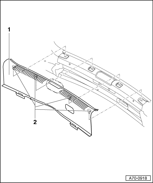

harddrive Posted April 7, 2007 Report Share Posted April 7, 2007 [ QUOTE ] i have remove torx screws from under wheel arches 2 outer 4 inner both sides. [/ QUOTE ] Your next step should be to remove the trim in the boot: 1 - Rear cross panel trim t Removing – Take floor covering out of luggage compartment. – Remove luggage compartment light → Chapter. – Unfasten the rear cross panel trim -1- upwards from the clips -2- (4x). Quote Link to comment Share on other sites More sharing options...

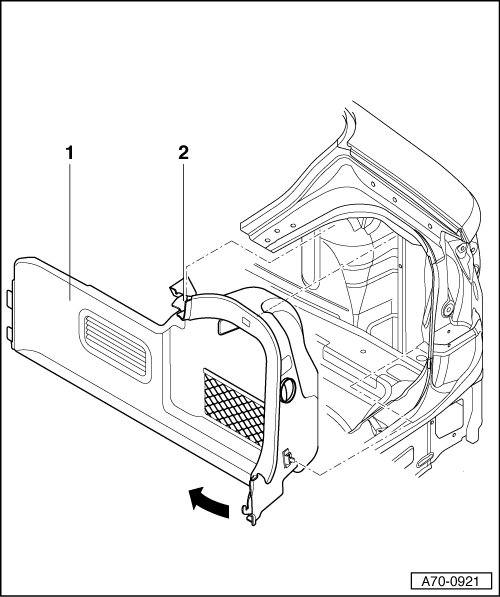

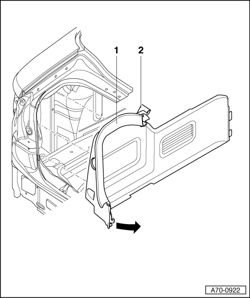

nickbell Posted April 7, 2007 Author Report Share Posted April 7, 2007 thanks for these. I am still not very sure where these screws are located. do i have to remove the boot lining? Quote Link to comment Share on other sites More sharing options...
harddrive Posted April 7, 2007 Report Share Posted April 7, 2007 1 - Right side trim t Removing – Take out luggage compartment floor covering. – Remove the rear cross panel trim → Chapter. – Remove the handle mount trim → Chapter. – Remove the convertible top compartment flap → Chapter. – Remove luggage compartment light → Chapter. – Unfasten clip -2-. – Pull off right side trim -1- in direction of arrow. Quote Link to comment Share on other sites More sharing options...
harddrive Posted April 7, 2007 Report Share Posted April 7, 2007 1 - Left side trim t Removing – Take out luggage compartment floor covering. – Remove the rear cross panel trim → Chapter. – Remove the handle mount trim → Chapter. – Remove the convertible top compartment flap → Chapter. – Unfasten clip -2-. – Pull off left side trim -1- in direction of arrow. Quote Link to comment Share on other sites More sharing options...
