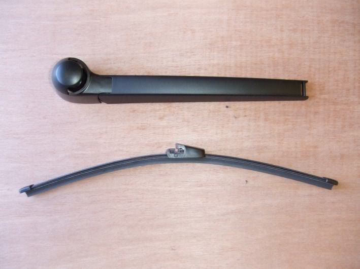

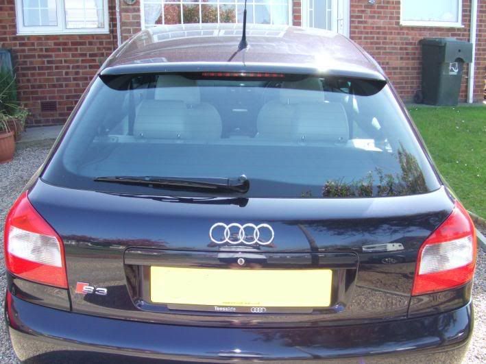

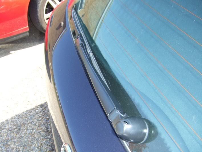

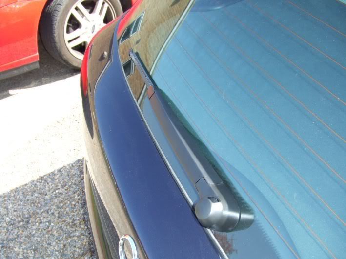

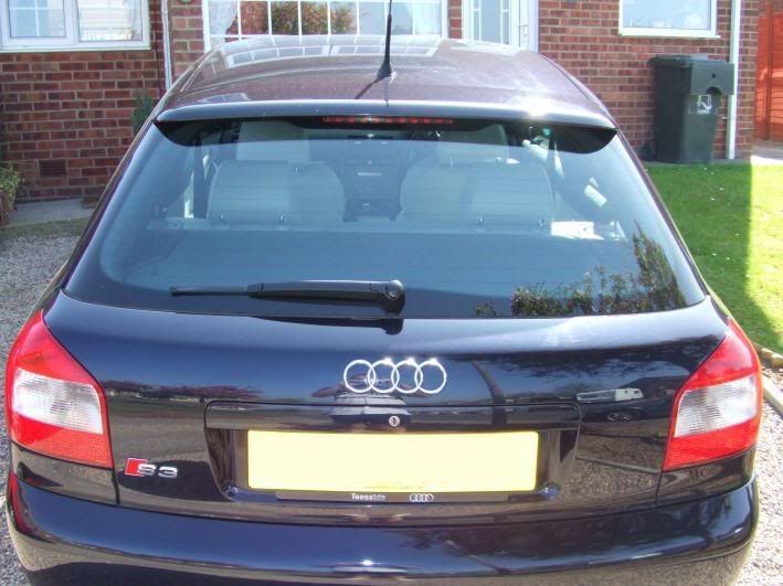

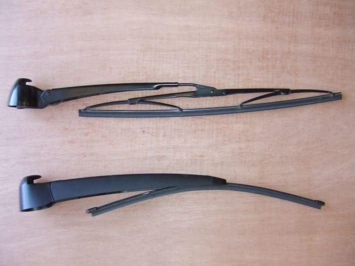

Tunbridge Posted April 15, 2007 Report Share Posted April 15, 2007 The rear wiper on my S3 (8L) has been knackered since the frost got it over the winter so I decided to upgrade to the Rear Aero Wiper as a much sleeker alternative to the standard set up. I know this has already been posted on here before but here is my take on it and a bit more info that I don’t think was covered in previous posts. First things first, the part you need is: Polo 2003> Rear Aero Wiper – Silicone Rubber – Part No.6Q6 998 425 I bought mine from vagparts at a cost of £19.04 including p+p. This is what you get… This is what the car looked like with the standard arrangement… You need a 13mm spanner to remove the nut but that’s about it. It is worth noting that the Aero wiper does not have splines like the original but this doesn’t seem to have made any difference to the operation. The only time you might get problems is if your wiper has frozen to the window. Another point is that the polo wiper is about an inch shorter than the standard unit (see photo below) but I believe this can be rectified by fitting the blade from a Touran, personally I think its fine as it is and still has adequate coverage. You might also have noticed that you have to fit the wiper upside down as the parked position on the polo is on the opposite side to the S3, but again this doesn’t really mater. So here it is all finished… Well worth it for less than £20 quid Link to comment Share on other sites More sharing options...
Paul Posted April 15, 2007 Report Share Posted April 15, 2007 Just replaced mine for MOT as it had started juddering across the screen. I had the slightly longer Touran Blade (in the polo arm)first time around, and it clears the spoiler. Now I have the slightly shorter Polo blade, purely because I bought it from vagparts shop, as an off the shelf purchase. worth noting I had to "tweak" the plastic cap that sits over the spindle and nut, as it was touching the glass. You just need to do the fronts now Link to comment Share on other sites More sharing options...
Tunbridge Posted April 15, 2007 Author Report Share Posted April 15, 2007 [ QUOTE ] worth noting I had to "tweak" the plastic cap that sits over the spindle and nut, as it was touching the glass. [/ QUOTE ] I'll have to look out for that, I haven't really run the wiper in anger yet, seen as I've been basking in the sunshine [ QUOTE ] You just need to do the fronts now [/ QUOTE ] Next on the list, as soon as they split Will also be worth checking to see how the new set up goes with the RainX, I'm a big fan of RainX but there doesn't seem to be a lot of love for it on here Link to comment Share on other sites More sharing options...
