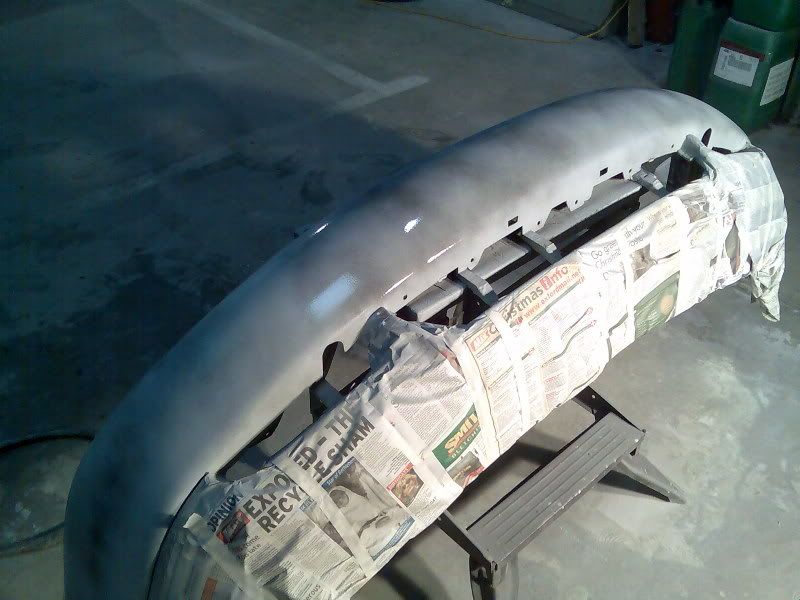

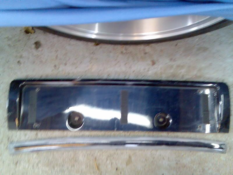

mkoneman Posted May 13, 2007 Report Share Posted May 13, 2007 back to modding the outside this week whipped the front bumper off and started chopping it about it had a dent in the front and a almighty crack on the underside from the careless previous owner the car never gets dirty enough to need the headlight washers so they went in the bin, then i pulled off the numberplate recess and cut it up then made up some infill panels and part of the original recess to smooth it over all welded into place next i had to repair the cracked section of the lower valence made op of several sections then with the rest of the bumper smoothed the feature line had to go here it is in prep that's as far as i got so far more updates to follow Quote Link to comment Share on other sites More sharing options...

mkoneman Posted May 17, 2007 Author Report Share Posted May 17, 2007 **update** bumper is in primer now its been hard work i should have the top coat on by saturday Quote Link to comment Share on other sites More sharing options...

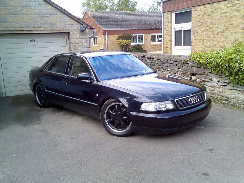

mkoneman Posted May 19, 2007 Author Report Share Posted May 19, 2007 one week later and its back on, i think at a pro body shop id would be looking at £500-£700 to get that done in man hours i got it done in total for £60 in parts here it is still needs a wet flat but im pleased with the way it turned out watch this space for more............... Quote Link to comment Share on other sites More sharing options...

mkoneman Posted May 19, 2007 Author Report Share Posted May 19, 2007 lol, wet flat is where you use really fine sand paper (2000 grit etc) to flat the paint down to remove imperfections then use a porter cable polisher to bring to a really good shine Quote Link to comment Share on other sites More sharing options...

mkoneman Posted August 21, 2007 Author Report Share Posted August 21, 2007 here we go again................ front bumper back off for a repaint time to get the back one matching the front... smoothing the line out and gloss blacking the lower halfs of the bumper and a few other bits i have done £3.85 S8 mirrors and my show plate few other things in the pipeline alont the lines of rear camber and spacers Quote Link to comment Share on other sites More sharing options...
