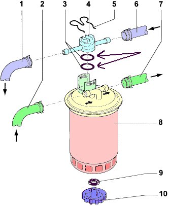

apples Posted June 11, 2007 Report Share Posted June 11, 2007 Hi all, On my 1.9TDi i have a slight diesel leak at the fuel filter, is this a common fault? all the pipes seem to be on tight, so i'm thinking one of the hoses are split? Quote Link to comment Share on other sites More sharing options...

sotty Posted June 12, 2007 Report Share Posted June 12, 2007 [ QUOTE ] Hi all, On my 1.9TDi i have a slight diesel leak at the fuel filter, is this a common fault? all the pipes seem to be on tight, so i'm thinking one of the hoses are split? [/ QUOTE ] Apples, I had the same just after the last service. I found the it was the 2 "o" ring seals on the valve that clips into the top of the filter. Try replacing them first. Quote Link to comment Share on other sites More sharing options...
