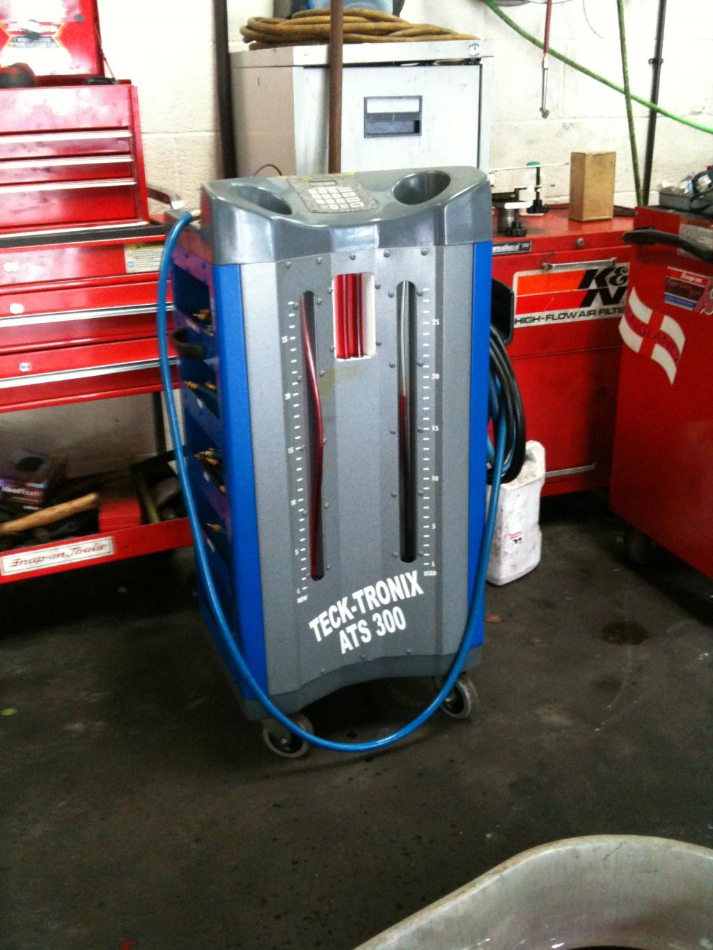

IT_S8 Posted January 25, 2009 Report Share Posted January 25, 2009 Thumbs up from me too, its one of the transmission specialists that I'd recommend for (a) knowing their stuff and (b) actually doing something useful with that knowledge! There super-sucky-pumpy-squirty oil changing system is the nuts too. Link to comment Share on other sites More sharing options...
Architex mA8tey Posted January 25, 2009 Report Share Posted January 25, 2009 There super-sucky-pumpy-squirty oil changing system is the nuts too. God Ian sometimes you are talking just tooooo technical for me Please dont tell me you used to be a civil servant? Link to comment Share on other sites More sharing options...
jmw748 Posted January 25, 2009 Author Report Share Posted January 25, 2009 There super-sucky-pumpy-squirty oil changing system is the nuts too. I think that's what the sticker on the machine actually said on the prototype, but then the marketing folks got involved! Link to comment Share on other sites More sharing options...

harpersimon Posted January 26, 2009 Report Share Posted January 26, 2009 There super-sucky-pumpy-squirty oil changing system is the nuts too. I think that's what the sticker on the machine actually said on the prototype, but then the marketing folks got involved! AKA: The TECH-TRONIX ATS300 "Its Super, and it Sucks.. " Link to comment Share on other sites More sharing options...

jonlittle Posted August 5, 2010 Report Share Posted August 5, 2010 Hi there, after reading all these threads I took 2 trips to Chester Transmissions and on the second time had my ATF changed in my 1996 4.2 Quattro Sports with a 4 SPEED tranny, which was actually changed back in May this year by Carvers in Denton (DONT USE THESE GUYS BY THE WAY) when I should have gone straight to Chester who are the real guys!!!....the super-sucky-pumpy-squirty oil changing system is actually a machine they used to import and sell from Canada and thought you would now like a picture........:- Link to comment Share on other sites More sharing options...
