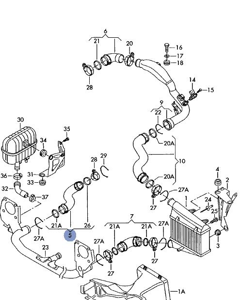

Wobby Posted May 22, 2007 Author Report Share Posted May 22, 2007 Had the car up on the ramps and the bottom of the 'S' pipe has a 2" split! Looks a simple fit and will get one ordered in the morning. Anyone know what price these are? I nearly had to be stretchered out of a dealers last year when they told me how much something was!! Then i had to go back to the bank for more money Link to comment Share on other sites More sharing options...
Rustynuts Posted May 22, 2007 Report Share Posted May 22, 2007 Which one of these is it? Number 5 or number 10? Link to comment Share on other sites More sharing options...
Wobby Posted May 22, 2007 Author Report Share Posted May 22, 2007 hhmmmmm, i think its number 5. Its straight off the bottom of the turbo to the steel tube that runs across the front. Link to comment Share on other sites More sharing options...
Rustynuts Posted May 22, 2007 Report Share Posted May 22, 2007 That's the expensive one. The other one is about £30 I think, but number 5 is possibly twice as much. Maybe wrong though, and you might be able to wrangle a bit of a discount aswell. Link to comment Share on other sites More sharing options...

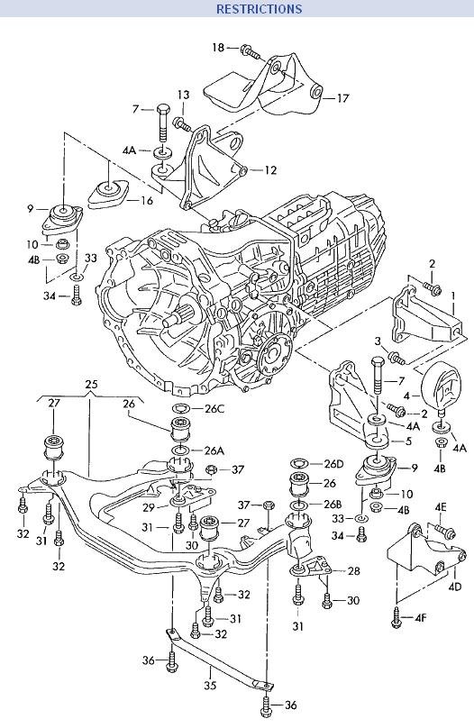

Wobby Posted June 1, 2007 Author Report Share Posted June 1, 2007 Wayhay!! Fitted new part!! £63.00 +VAT, but they gave me a 7.5% discount (this was after they had got me off the floor and sat on a chair and taking notice after the initial price shock) "Nearly £80 for a bit of f**king hose", was my first response. Cars like a rocket now, an RS4 tried to get past but i just blew him away Top clip a bit tricky to get on, took about 15 mins once i got her on the ramps. Next question , while on the ramps and checking for any boost losses i noticed what i can only describe as significant vibration/ movement in a mount! It off the gearbox and the left hand side when looking under from the front. Other mounts seem solid with no movement. On this one the plate at the bottom is vibrating alot! Guessing its worth changing, any ideas of cost? Link to comment Share on other sites More sharing options...
Rustynuts Posted June 1, 2007 Report Share Posted June 1, 2007 I'd do it at the same time as the timing belt, mate. Link to comment Share on other sites More sharing options...
Wobby Posted June 1, 2007 Author Report Share Posted June 1, 2007 ha ha, i asked for that one Nearly 100k on the timing belt now!! Its getting ready for changing. Link to comment Share on other sites More sharing options...
Rustynuts Posted June 1, 2007 Report Share Posted June 1, 2007 Which one is it? Give me a number or mark an arrow on this drawing. Link to comment Share on other sites More sharing options...
Wobby Posted June 1, 2007 Author Report Share Posted June 1, 2007 Hmmmm, not too sure! Looking at the gearbox from the input shaft end as in the picture it is the mounting on the left (farthest away) side. I think 9 is the bit that moving, is it 2 part with 9 bolting through 16? Or is that mount off the top? Going to take the offer up off PM when i get sorted Link to comment Share on other sites More sharing options...
