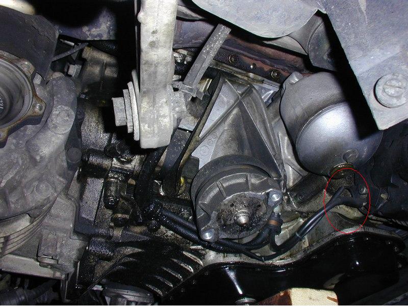

tested the cable at box#10 mentoned above and they seem ok. also tested the connection to the alternator ok as well.
I did't manage to test the starter, mainly because I couldn't find it.
on the attached pic, which is from audiworld,I've circled the cables that supposedlly go to to starter. well not on my car. those exact cables end on the alternator:confused:

I posted a picture on audiworld to your thread. I would bet 2:1 that this is your problem.

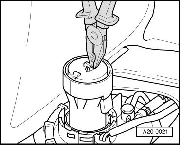

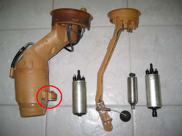

my main problem now is how do I get the pump out.
I have disconnected all the lines and electrical connection. undone the big black round thing.
I haven't undone the smaller yellow round . is that necessary?
I don't seem to be able to get it out. I can raise it a bit , about an inch, but sommething seems to be in the way. any hints?
the ELSA icons haven't been of much help
