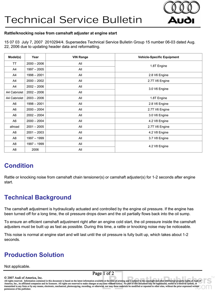

waynester2 Posted September 16, 2008 Report Share Posted September 16, 2008 Hey Guys, As it starting to get colder, I am noticing the start-up first thing in the morning is getting noisier, sometimes its perfect but sometimes it sounds like theres ball bearings rattling around, but only for the initial rev once its fires (I guess controlled by the ECU as foot not on the throttle when it does it). Engine is V8 4.2 code AUW I used to get something similar with a 1.8t A6 I had, and that was due to hydraulic tappets not been energised enough during start, due to the pressure taking a second to come up.(but it was only 1 in 10 starts) Does the V8 suffer this as well? is it doing any damage? as soon as its started there is no problem, its only on the computer controlled initial surge, would an oil change help? Be interested in any comments on this. Thanks W Link to comment Share on other sites More sharing options...

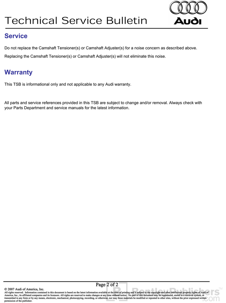

A8 Doc Posted September 17, 2008 Report Share Posted September 17, 2008 (edited) Here is some info for you, hope it helps. Edited December 25, 2009 by Figure11 Link to comment Share on other sites More sharing options...
waynester2 Posted September 17, 2008 Author Report Share Posted September 17, 2008 I guess thats reassurance! has anyone else noticed it ? Link to comment Share on other sites More sharing options...
Oli18 Posted September 17, 2008 Report Share Posted September 17, 2008 I have and i have had that same explanation given to me...it's a funny tapping noise for about 2 seconds that makes you start getting paranoid but i've had my car for almost 1 1/2 years and it's absolutely fine! Link to comment Share on other sites More sharing options...

spitanddirt Posted November 21, 2008 Report Share Posted November 21, 2008 You guys aren't the only ones who have experienced it. I just bought my A8 and the first time I heard it, I thought I had a connecting rod bearing shell out! Whoever posted that tech bulletin, thank you so much. I thought I was about to lose my mind with that noise. And for me, it does it when it's cold and the car has sat overnight. First start of the day, it's guaranteed to knock. Link to comment Share on other sites More sharing options...
