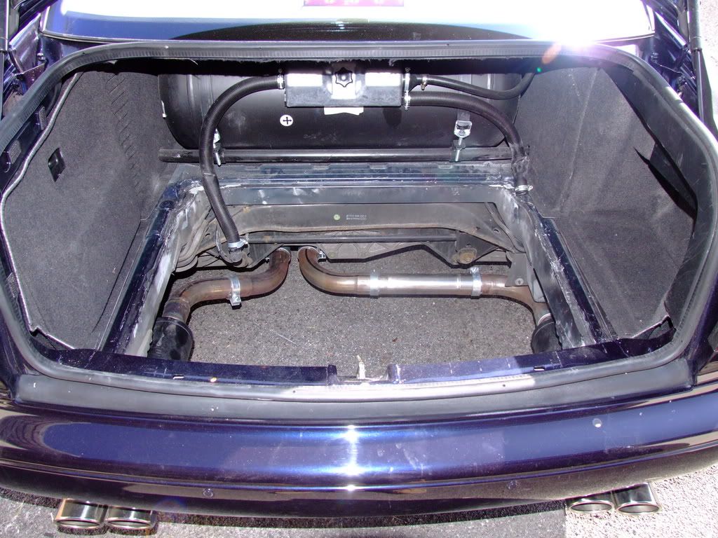

Ska Posted December 9, 2008 Author Report Share Posted December 9, 2008 (edited) How are you planning the amps. I am considering moving it all here Got the idea from Mike Just got to figure out how to cool it all. You'll notice I'm supporting the boot floor with a screw driver while I took the pic, yes I realised afterwards by mistake that the handle is also the proping leaver:rolleyes: Edited December 9, 2008 by Ska Link to comment Share on other sites More sharing options...
DJStrange Posted December 9, 2008 Report Share Posted December 9, 2008 I'm going for some sort of box-out for the amps, I built one for the vectra and mounted a couple of 120mm pc cooling fans on a fan controller off a relay. I'd use my wheel well but I daren't travel the distances I do without a spare, especially when I'm eventually towing the caravan off to another job. Alternatively, I think I'll be having a look at the two compartments behind the wheel wells (an amp in each), but I need to have a look at how much space there is and mounting/cooling/wiring options. The good thing about having the single 12" sealed is that it doesn't take up an awful lot of room really, so there's that to think about too... Lots of thinking and not much action at the moment!! Link to comment Share on other sites More sharing options...
Figure11 Posted December 9, 2008 Report Share Posted December 9, 2008 DJ, Just think what you could do with this space.. I havent had a puncture in 7 years! Its all risk managment. Mike Link to comment Share on other sites More sharing options...
DJStrange Posted December 9, 2008 Report Share Posted December 9, 2008 Yes indeed, I see the space. Not sure I want to change too much from standard S8 though to be honest - my turn to go all purist You using metal in your plans or something else? Fuel tank was it? Link to comment Share on other sites More sharing options...
