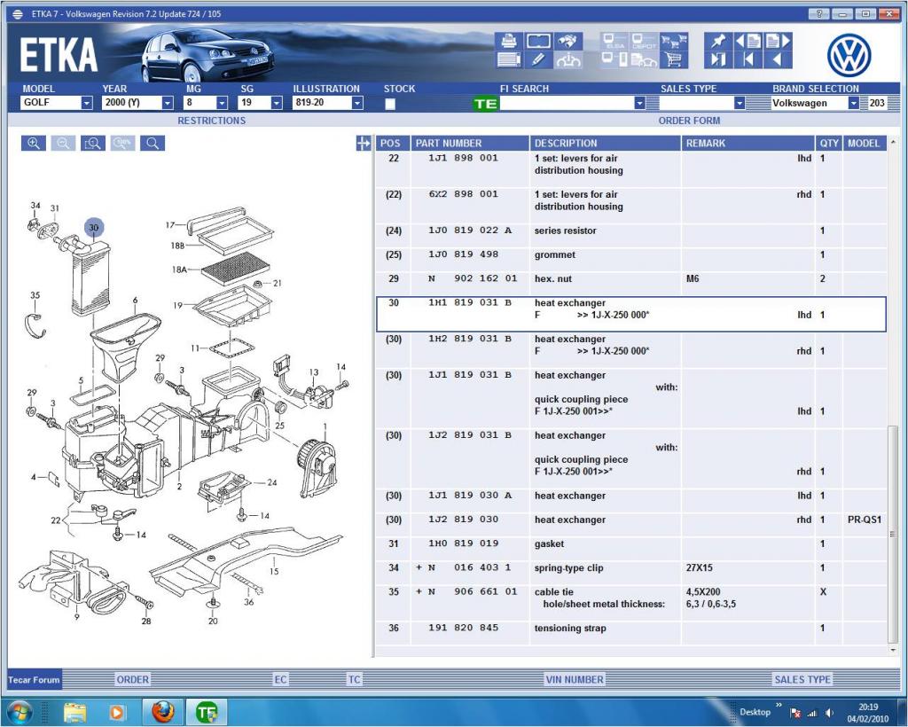

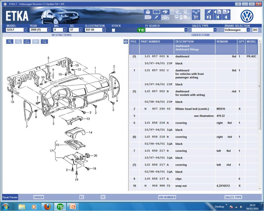

cruiser647 Posted February 4, 2010 Report Share Posted February 4, 2010 Are these any good? Link to comment Share on other sites More sharing options...
macdaddy2x Posted February 5, 2010 Author Report Share Posted February 5, 2010 Cruiser, these images are great but I think they are for the MK 4... any chance of the MK 5 ones? Thanks again. Link to comment Share on other sites More sharing options...
cruiser647 Posted February 6, 2010 Report Share Posted February 6, 2010 Cruiser, these images are great but I think they are for the MK 4... any chance of the MK 5 ones?Thanks again. D'oh! Will try! Link to comment Share on other sites More sharing options...

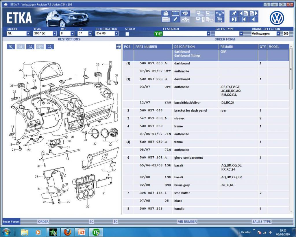

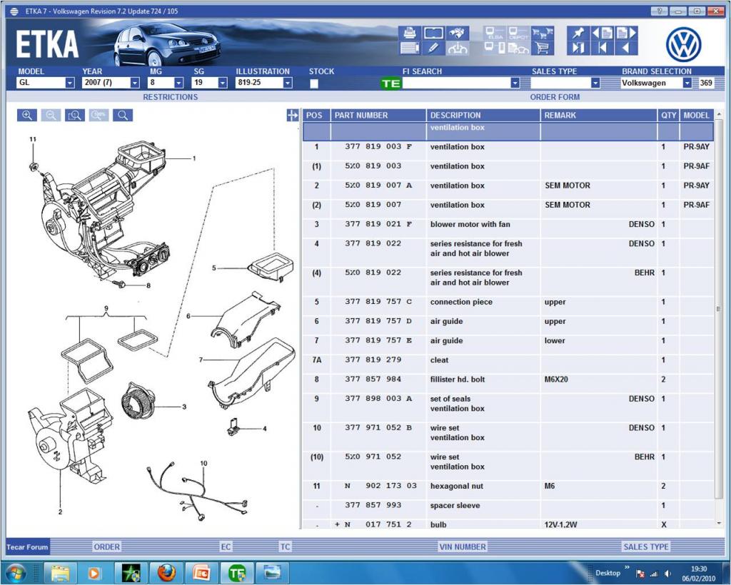

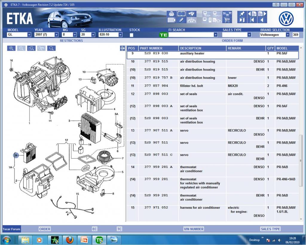

cruiser647 Posted February 6, 2010 Report Share Posted February 6, 2010 Try these! Hopefully a bit better. Link to comment Share on other sites More sharing options...
macdaddy2x Posted February 8, 2010 Author Report Share Posted February 8, 2010 Lovely mate... thank you very much! Will update when the job is done to add any info for anyone else doing this job in future. Link to comment Share on other sites More sharing options...
dazseaton Posted February 19, 2010 Report Share Posted February 19, 2010 thanks for those exploded schematics, just what i was after (as haynes manual is woefully inadequate). Climatic heater on a mk5 golf. Is mine broken or are they all crap?? Sometimes When its cold and you turn the heater on to demist the screen it mists up really badly and takes ages to clear. Also the heat output is feeble especially in the front footwells (glad its got heated seats). had the glovebox out to check for leaks around the matrix but without dismantling the whole car couldnt find anything. The heat control stops moving the solenoid at about the three o'clock position so may have a look at that tomorrow although had a play with a guys at work and his was the same. he wasnt impressed with the heater either but his is an early tdi (without the electric heater i presume). Link to comment Share on other sites More sharing options...
