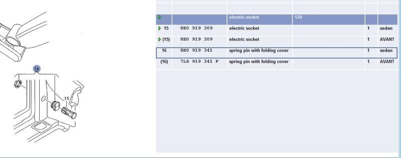

Andy_Bangle Posted March 30, 2010 Report Share Posted March 30, 2010 What year is your car? Does the part look like the one below: Link to comment Share on other sites More sharing options...
sw20audia4 Posted March 30, 2010 Author Report Share Posted March 30, 2010 Yes:D! Thanks so much for this Andy_Bangle. My car is a 2006 55-plate A4 Avant 2.0T FSI Quattro S-line... I can't make it out very clearly, but it does look very similar to that. I am wondering if I buy the whole electric socket etc. whether I can simply take the cover off the new one and attach to the already installed one as that appears to have a couple of pins to hold the cover flap. If anyone has one of these installed in their Avant could you have a look and confirm / refute if this might be possible? Thanks... SQ20AudiA4 Link to comment Share on other sites More sharing options...

mb Posted March 31, 2010 Report Share Posted March 31, 2010 Just had a quick look at mine & I would say it is going to be a panel out job to install it (the pic shows a nut holding it in which suggests the same). The load-liner mostly covers mine so a cig lighter blanking plug and loadliner would probably be the easiest option, or even LL & aforementioned cork ! Link to comment Share on other sites More sharing options...
sw20audia4 Posted April 3, 2010 Author Report Share Posted April 3, 2010 Thanks all for your help. Just thought I would post a note to say that I ordered the new socket housing (the Avant one of the items highlighted). I initially looked at taking the panel out to completely replace the existing socket holder. Hmm - got about 20 minutes in and thought I would stop for fear of making a complete mess:eek:. 20 minutes out, with a cup of tea and I took the decision to simply replace the spring loaded cover (the one that was already in the boot still had the two hinge pins in perfect working order). So, a few minutes with a bit of cotton and a cupboard closing stopper (the little half spherical rubber bits from kitchen cupboards - £1 for a hundred from B&Q) which I used to keep the free end of the spring held back (by stabbing it into it) and I managed to replace just the covering flap. Now, 12V socket like new, all for the princely sum of £6 ! Thanks, and happy Easter one and all. Link to comment Share on other sites More sharing options...
