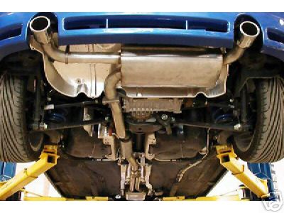

Ers Posted November 21, 2004 Report Share Posted November 21, 2004 I love the look of the R32 rear end and would like to fit the twin exhausts to my GT TDI. Do any of you know if it is possible. Cheers Link to comment Share on other sites More sharing options...
Ritey Posted November 21, 2004 Report Share Posted November 21, 2004 To get a working dual exit like the R32 I "believe" some serious boot panel work has to be done to fit the boxes under the car Link to comment Share on other sites More sharing options...
lionheart Posted November 21, 2004 Report Share Posted November 21, 2004 (Almost!) Anything is possible... It just comes down to HOW MUCH you really want it!! Link to comment Share on other sites More sharing options...
Ers Posted November 21, 2004 Author Report Share Posted November 21, 2004 I don't really want to start cuting and bashing panels. I was hoping I could just change the rear bumper and stick the r32 exhaust in. Cheers guys Link to comment Share on other sites More sharing options...
mb Posted November 21, 2004 Report Share Posted November 21, 2004 The rear panel is definitle cut away to make room (why we can't tow anyone...) so I wouldn't bother if I were you. That said the panel just looks as if it was cut off by a monkey with an angle grinder so it wouldn't be too hard to replicate a factory quality job ! IMHO the 2 zorts are the worst aspect of the car - though I am sure most will disagree ! Link to comment Share on other sites More sharing options...
mb Posted November 21, 2004 Report Share Posted November 21, 2004 also don't forget the Hadex may make alignmnet different on an not AWD Golf ? Link to comment Share on other sites More sharing options...
Gti_Fly Posted November 21, 2004 Report Share Posted November 21, 2004 You can fit an R32 exhaust to a 2wd golf, but it does involve completely cutting away the spare wheel 'well' to allow for the backbox. This modification has been done by a guy on the uk-mkivs.net forum. Link to comment Share on other sites More sharing options...
