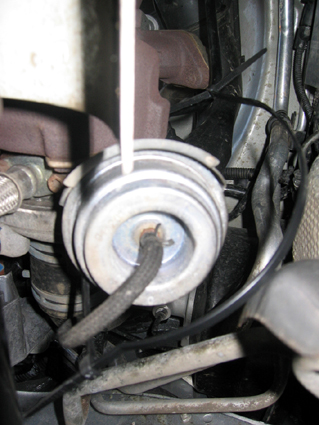

fluorspar Posted September 2, 2005 Author Report Share Posted September 2, 2005 Hi Folks... Just an update. Recently I have been much more violent with the old accelerator pedal and I think the car seems to like it. On a few occasions I have redlined it 2nd, 3td and 4th without the turbo cutting out, but on most occasions especially going up hill it cuts out at between 3-4000 rpm. Anyway testing & investigations continue.... This evening I decided to reassure myself that the VNT actuator arm was indeed not stuck, and wary of hurting my delicate fingers & thumbs, I have invented the delux VNT Exersiser. (Pictures attatched) This unique device cunningly fashioned from 2 stout cable ties, is operated from below the car. It is passed over the top of the actuator arm, thus affording an easy means of both pulling with one hand and pushing with the other. Lubrication can also be applied to ease the process. Patents Pending. ...... Take care all. Link to comment Share on other sites More sharing options...
