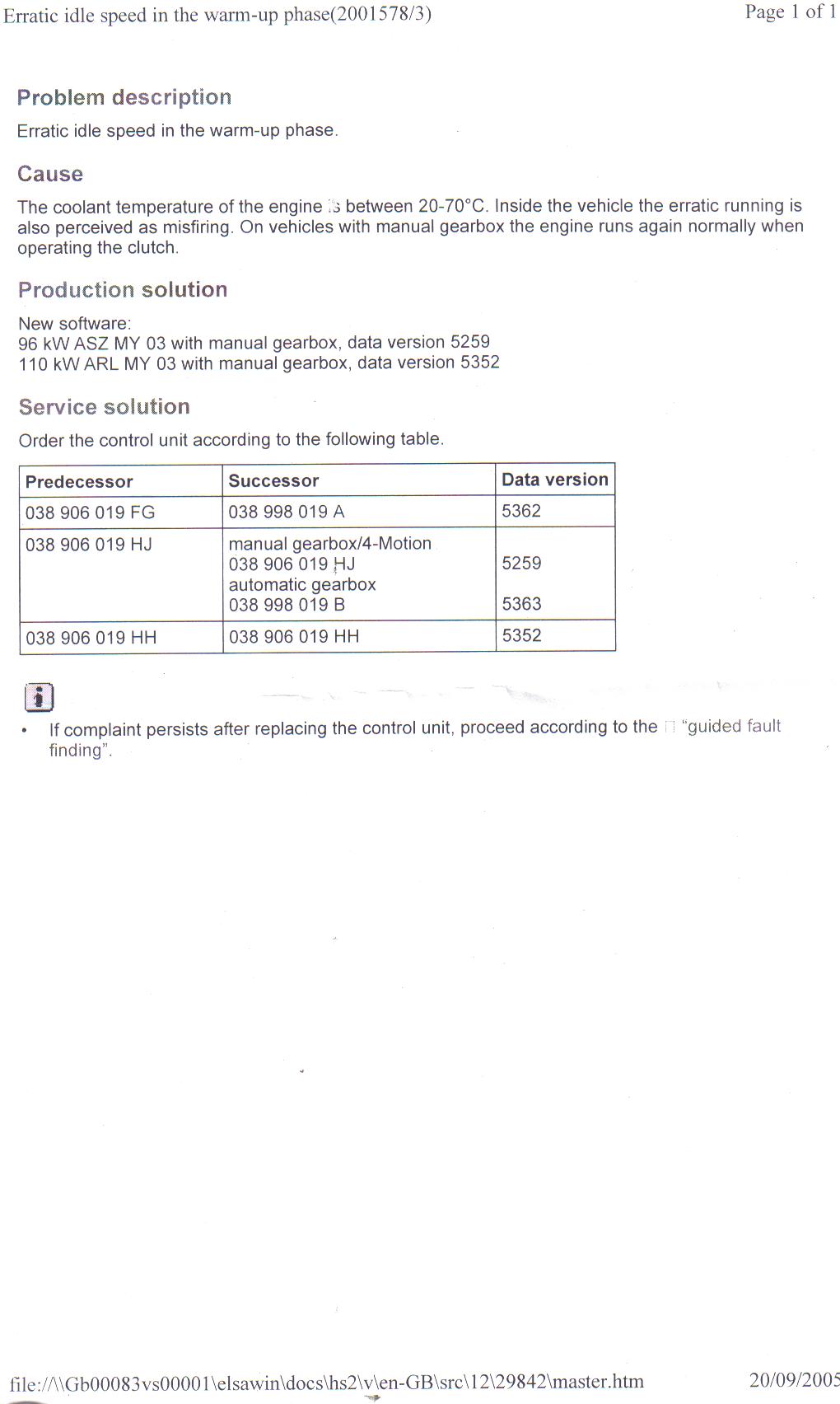

pingpongpo Posted September 19, 2005 Author Report Share Posted September 19, 2005 Hey guys! Just had words with my local stealer and they are going to sort out my wheels They reckon if you've got any scratches on them, VW will reject them back so be careful there. Anyhow, they have ordered some wheels and caps for me so I will go back next week to have them fitted. On the business of the juddering, I mentioned to the service manager that it is an ECU problem and quite a common fault. He said he hadn't heard of any such thing and that if I could provide the bulletin number on which this is stated, they could do something about it. Anyone got any idea what the bulletin number is for this fault? Link to comment Share on other sites More sharing options...
mulkbear Posted September 19, 2005 Report Share Posted September 19, 2005 It is not a recall but it is a techinal bulletin , i will find out and post some info Link to comment Share on other sites More sharing options...
pingpongpo Posted September 19, 2005 Author Report Share Posted September 19, 2005 [ QUOTE ] It is not a recall but it is a techinal bulletin , i will find out and post some info [/ QUOTE ] Cheers Mate, I would really appreciate it. Link to comment Share on other sites More sharing options...

mulkbear Posted September 21, 2005 Report Share Posted September 21, 2005 I think this is the info you lovey people have been looking for Link to comment Share on other sites More sharing options...
pingpongpo Posted September 21, 2005 Author Report Share Posted September 21, 2005 [ QUOTE ] I think this is the info you lovey people have been looking for [/ QUOTE ] I think I may want to have your babies. I'll let you know how I get on tomorrow Link to comment Share on other sites More sharing options...
