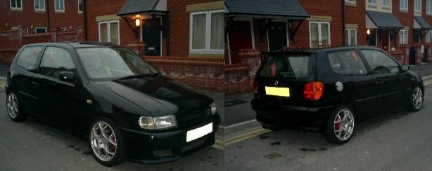

b4d4t Posted April 25, 2006 Report Share Posted April 25, 2006 Will it be enough if i lower the car to 40mm with 205/40/R17 as pictured below??? Thanks Link to comment Share on other sites More sharing options...
Si_GTi Posted April 25, 2006 Report Share Posted April 25, 2006 A 40mm drop will be the lowest you will be able to get the car on 17" alloys, they're really big for the wee Polo!! Even at -40mm you might find that you have trouble when you carry any kind of weight in the back (ie. passengers) and could find that the front tyres catch on full lock. If you want to go lower, then you will need to change to smaller alloys. 15" alloys are the preferred choice - could go up to -80mm with ease on 15x7 alloys with 195/45/15 - but you would be able to go to about -60mm with some arch work on 16" alloys if you preferred. HTH Link to comment Share on other sites More sharing options...

b4d4t Posted April 26, 2006 Author Report Share Posted April 26, 2006 These dont rub at all, was rubing the mud gards so i took them off and evryfin ok tunerd the car round full 360 still no rubbing maybe im just lucky Link to comment Share on other sites More sharing options...
