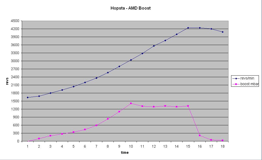

Hopsta Posted August 11, 2006 Report Share Posted August 11, 2006 Here's a graph of my AmD mapped S3, although it was about 3 years ago Link to comment Share on other sites More sharing options...
