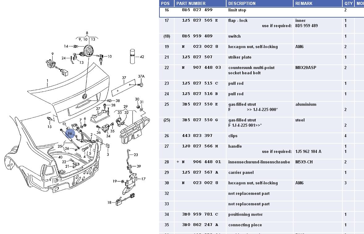

Rustynuts Posted April 22, 2007 Report Share Posted April 22, 2007 Here we are. Don't know which one you'd need, either the highlighted one or the one below it. Link to comment Share on other sites More sharing options...

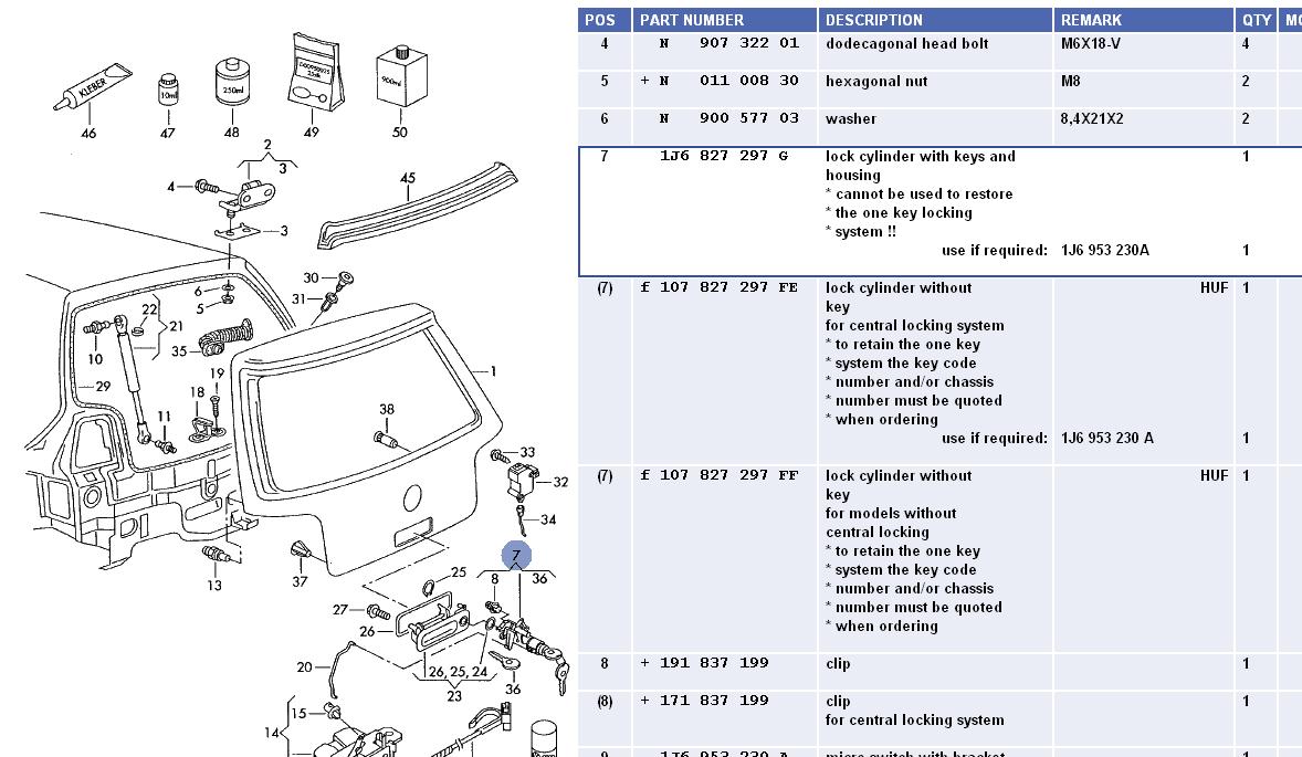

pomme Posted April 22, 2007 Author Report Share Posted April 22, 2007 Cheers, thats perfect just what i was after. Just wondering if you could do one last thing for me, and click on the first image so i can see what it says about parts: 16, 22, 23, 27, 28, 29, 30, 31, 32, 34, and lastly 35. Cheers Andrew Link to comment Share on other sites More sharing options...
Rustynuts Posted April 22, 2007 Report Share Posted April 22, 2007 This what you want. Link to comment Share on other sites More sharing options...

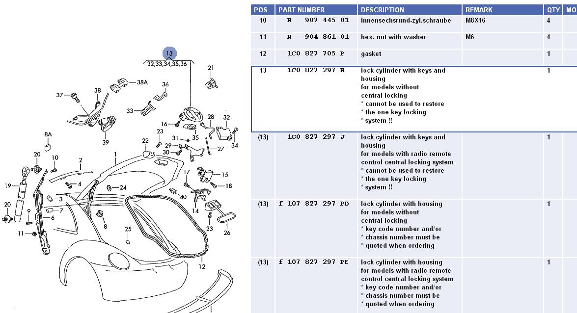

pomme Posted April 22, 2007 Author Report Share Posted April 22, 2007 Sorry i meant the beetle one if thats okay? Yeah i defenately will do that when i do this in the next month. Link to comment Share on other sites More sharing options...
Rustynuts Posted April 22, 2007 Report Share Posted April 22, 2007 Right, I had to chop out the bits you didn't ask for so it would fit on one page. Link to comment Share on other sites More sharing options...
pomme Posted April 22, 2007 Author Report Share Posted April 22, 2007 Thats brilliant, thank you so so much. Cheers Andrew Link to comment Share on other sites More sharing options...
