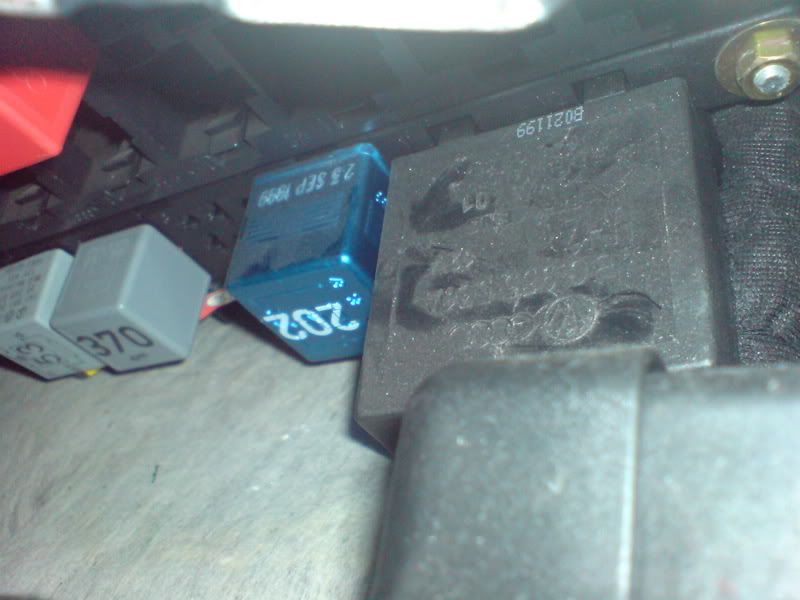

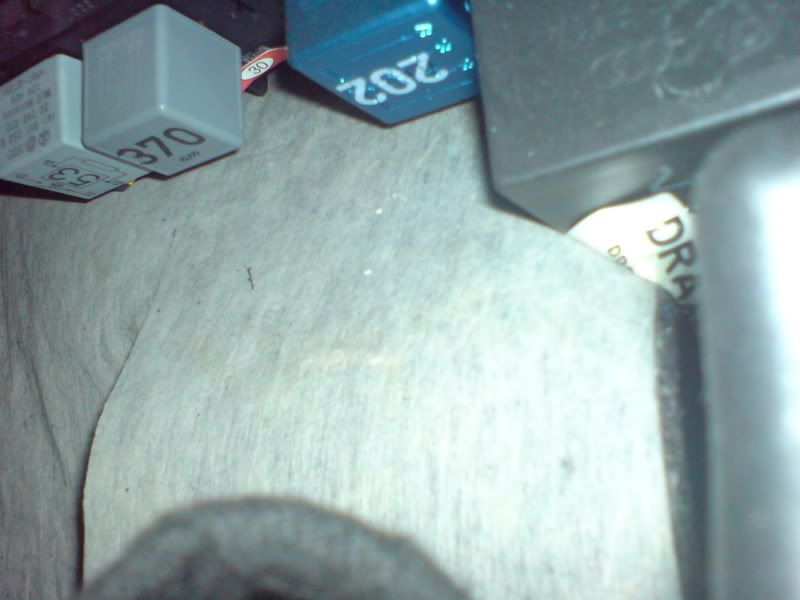

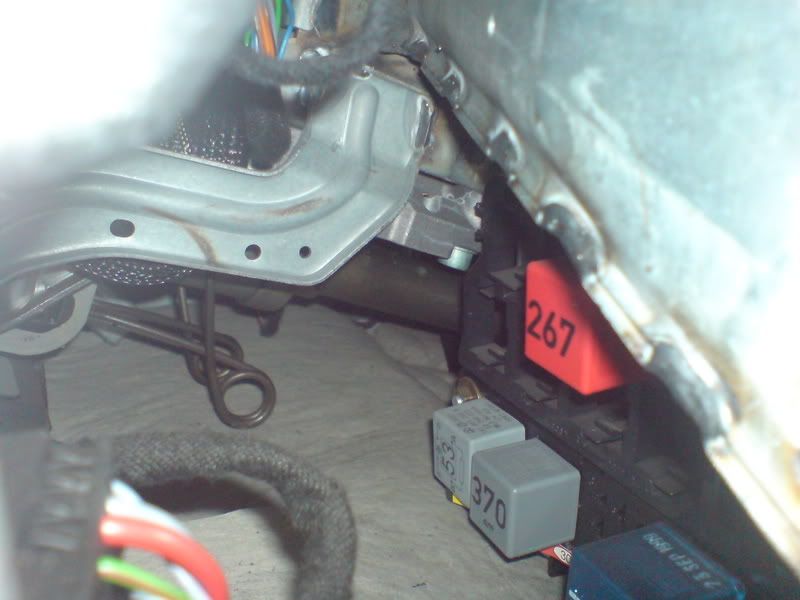

Evobaz Posted October 9, 2007 Author Report Share Posted October 9, 2007 Cheers for the reply. I'll try feeling the relays next time its clicking. I don't know anyone in my area with vagcom (central scotland). I'll have a look on google for the climatronic hidden menu thing. Thanks again. Baz Link to comment Share on other sites More sharing options...
