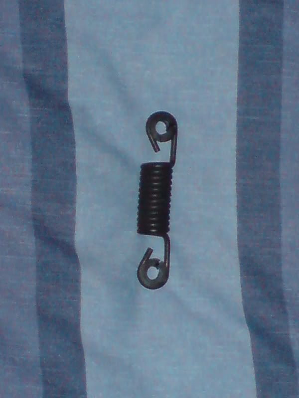

OK, So I got the call from Audi today to say that the two springs that I ordered have arrived. I'll collect them on friday and see how simple a job it will be!

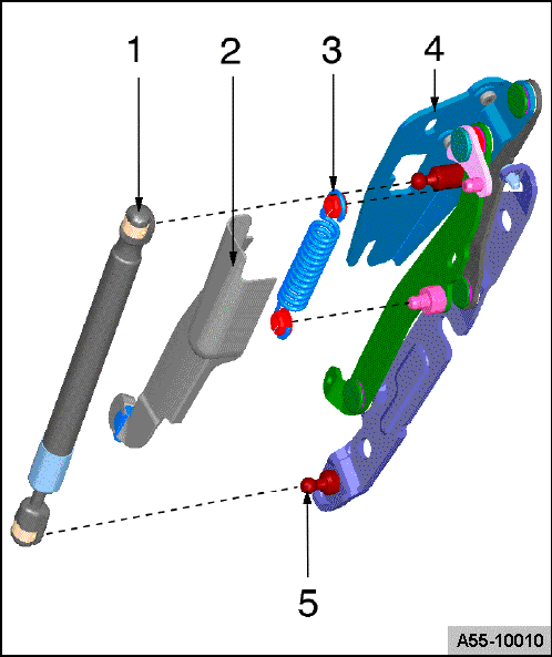

OK, well these are the springs, part no. 4F5827665A, they look correct with reference to the picture below
However the fixing points for the spring, circled in red below are not fitted to my boot hinges, so it looks like new boot hinges are required to complete this mod, Bugger!
