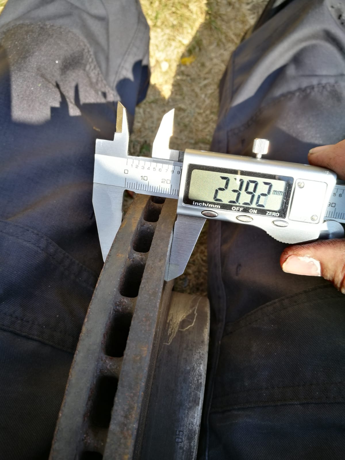

Update:  Time to replace the original brake disks. They were getting a little corroded on the outside and inside edges of the contact surface and a few score marks. Though, as the picture shows, after filing off the lips at the edges the thickness is still well above the minimum of 22mm  (new, they were 25mm).
Guess they could have been skimmed but anyway, I decided that a new pair, with pads, of Brembos would be a good idea.
