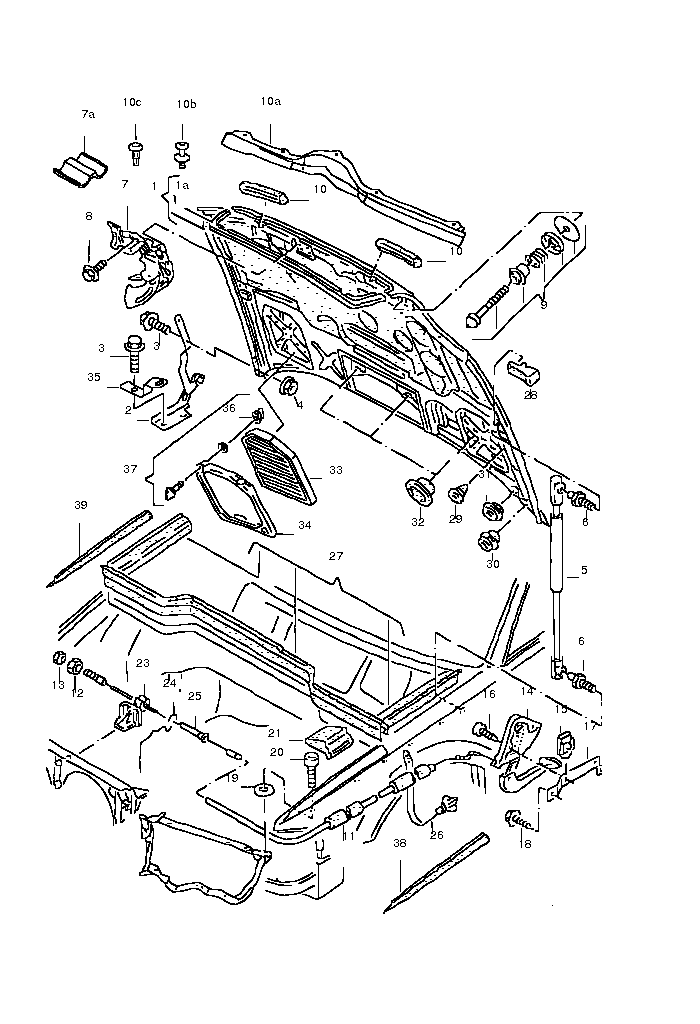

LostKiwi Posted January 16, 2008 Report Share Posted January 16, 2008 I think they are under the bonnet, attached to the bonnet at the trailing edge, one each side (they are in the '95s anyway). Its item 33 in the drawing. Link to comment Share on other sites More sharing options...
