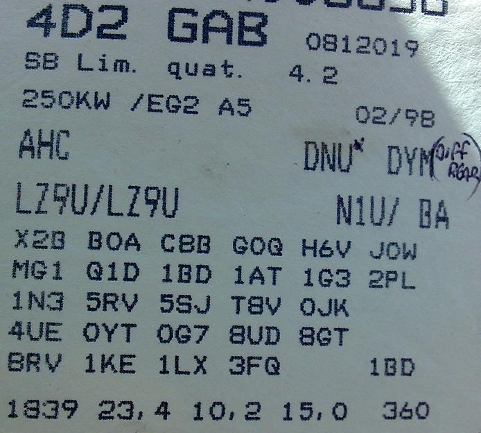

Here is the decode of you 8:
N1U = Silk napa leather seat covering
4D2 = Seat ventilation/massage seats, front and rear
X2B = National sales program Great Britain
B0A = Component parts set without country-specific design requirement
C8B = Alloy wheels 6.5J x 16 offset 50 (1Z0 601 025B)
G0Q = 5-speed automatic transmission for four-wheel drive vehicle
H6V = Tires 245/45 R 18 96Y
J0W = Battery 410 A (88 Ah)
MG1 = 8-cyl. gasoline engine 4.2 L/250 kW V8 Motronic, MVEG 2 base engine is T8V
Q1D = Sports front seats
1BD = Suspension/shock absorption for special sports design
1AT = Electronic stabilization program (ESP)
1G3 = Alloy spare wheel with original equipment tires
2PL = Leather trimmed sports steering wheel for air bag system with "S" badge
1N3 = Speed-related variable steering assist (Servotronic)
5RV = Right exterior mirror: aspherical
5SJ = Left exterior mirror: convex
T8V = 8-cylinder gasoline engine 4.2 L Unit 077.3 (aluminum)
0JK = Weight category front axle weight range 10
4UE = Air bag for driver and front seat passenger
0YT = Weight range 18 installation control only, no requirement forecast
0G7 = Tiptronic
8UD = Radio "concert"
8GT = Compact alternator 90 - 150A
8RV = 10 speakers (passive)
1KE = Disc brakes, rear
1LX = Disc brakes, front
3FQ = Electric sliding/pop-up sun roof with automatic pre-selection
Doesn't mention the trim! :(

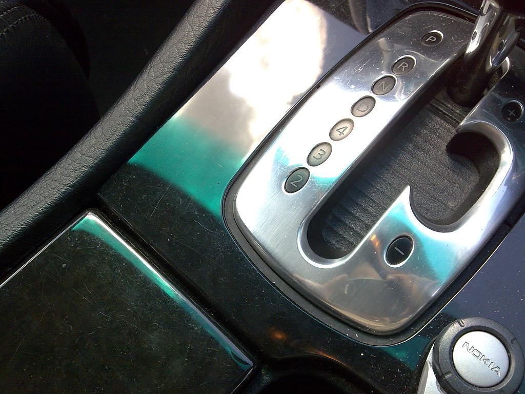

I have a facelift centre console trim that is lighter and more red coloured than my current trim so I think that must be walnut. I've seen the vavona trim in A8parts ebay shop which is even lighter so unless there are other colours available I think mine must be mrytle.
I wish... :-)
Think Mike got a bit trigger happy with the 3 letter codes there +++
4D2 is the car type, or 'D2' as we commonly call it.
I would say it was Dark Mrytle, I recall it when it came in, not least because it was the second car I'd ever seen with black headlining (Code BA on the build sticker)
Dark Mrytle was standard on the pre face S8 at one point, which may explain the lack of inventory on the build sticker.
Judging by the pic, I'd still say Myrtle.

Some nice sounding trim options there, I imagine most aren't available in RHD though. Anyway it looks like my trim is dark mrytle so now I just need to find a centre console trim in that colour (or replace the lot for something else).
