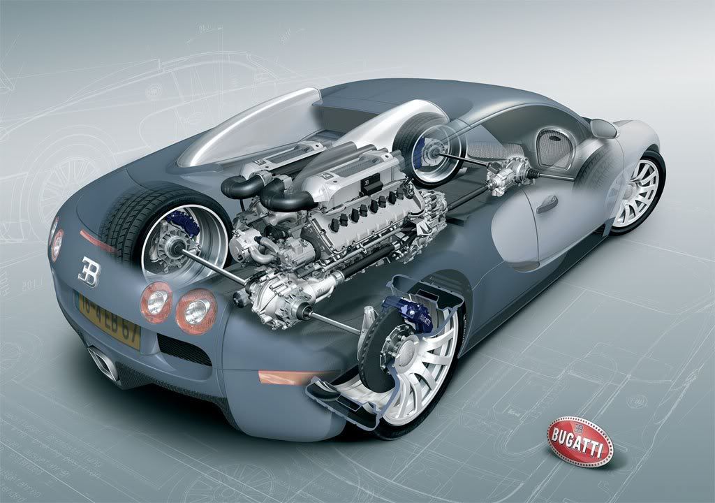

I'd be interested to know how the Veyron's system works. 2 x Haldex couplings?
Yup. +++
One at the front and one at the rear. And it doesn't actually have any "centre" diff at all - both front and rear props are permanently driven at equal speeds. :eek: And I gather the actual Haldex units needed some serious uprating to cope with the extra torque, because the standard units (like on the TTq/S3/R32) do have a torque handling limit. :rolleyes:
