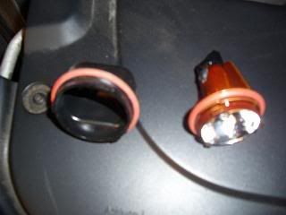

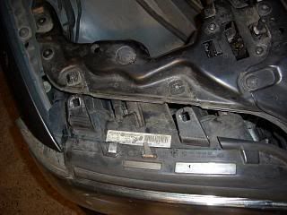

Grumman Posted April 5, 2009 Report Share Posted April 5, 2009 (edited) Assuming it is not a fuse, the 2 angel eyes on each side are lit by one bulb. approx £5. There are 4 x 8mm bolts to remove, then the Headlight unit slides forward JUST enough to get your hand round the back. You then twist the Cap Cover off with a slight turn. This gives access to the rear of the Bulb Assy, so you can pull the connector off, then the Bulb Unit iself comes out with another push in and twist. Edited April 5, 2009 by Grumman Link to comment Share on other sites More sharing options...
