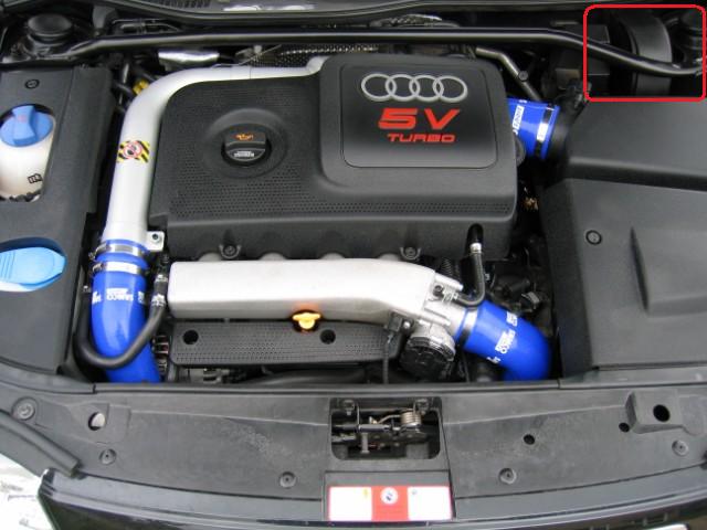

safety69 Posted March 22, 2009 Report Share Posted March 22, 2009 I was checking over my 8L model S3 and have found that the rear window washer is intermittent. When operating there seems to be a lot of the mixture coming from underneath the air filter housing pouring underneath the car. I assume that this has worked itself loose during the colder weather and needs to be pushed together again. I have removed the air filter housing but I cannot see where the pipe is located. Please can someone shed some light and is it a DIY job? cheers. Link to comment Share on other sites More sharing options...
Paul Posted March 22, 2009 Report Share Posted March 22, 2009 (edited) IIRC it is routed in a square (ish) section duct, that passes under the upper strut brace. Somewhere in this section is a push fit joint. Mollox had this issue, where as mine was the joint, the other end, behind the cd changer/ bose sub. Edited March 22, 2009 by Paul added photo Link to comment Share on other sites More sharing options...

fingermouse Posted March 26, 2009 Report Share Posted March 26, 2009 also had this one part, strip airbox out and loosen strut brace to get to s shaped conduit. Its in the middle ish of that section Link to comment Share on other sites More sharing options...
safety69 Posted March 28, 2009 Author Report Share Posted March 28, 2009 cheers for the info.... I managed to find and fix the connection. Link to comment Share on other sites More sharing options...
