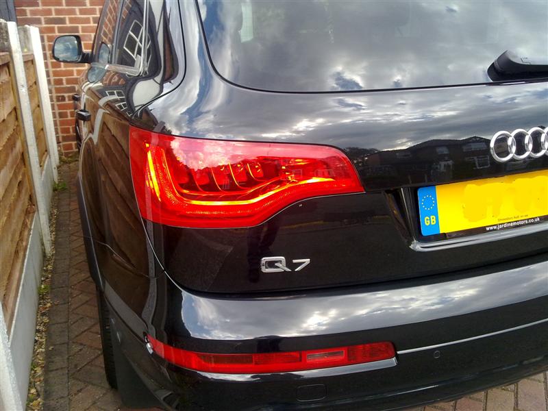

craigyb Posted May 12, 2010 Report Share Posted May 12, 2010 So I wanted to jazz up the Q7 and the rear lights seemed a good way to go. About 60 minutes work to strip the boot trim, remove the old lights, add some seals and fit the new lights. Remove the old convenience module 46 and install the new one and code it. Of course there is component protection to remove on the convenience module or your power boot open will not work. I got my dealer to do this and everything is good. Some pics to follow. Cost was 800 euros. Link to comment Share on other sites More sharing options...

craigyb Posted May 13, 2010 Author Report Share Posted May 13, 2010 As promised, it's too light to show them on. Link to comment Share on other sites More sharing options...
Dave Posted May 13, 2010 Report Share Posted May 13, 2010 Yea, i like those! are they the new lights from the updated Q7? Link to comment Share on other sites More sharing options...
craigyb Posted May 13, 2010 Author Report Share Posted May 13, 2010 Yep, they are 2010 facelift LED lights from the current Q7 Link to comment Share on other sites More sharing options...
