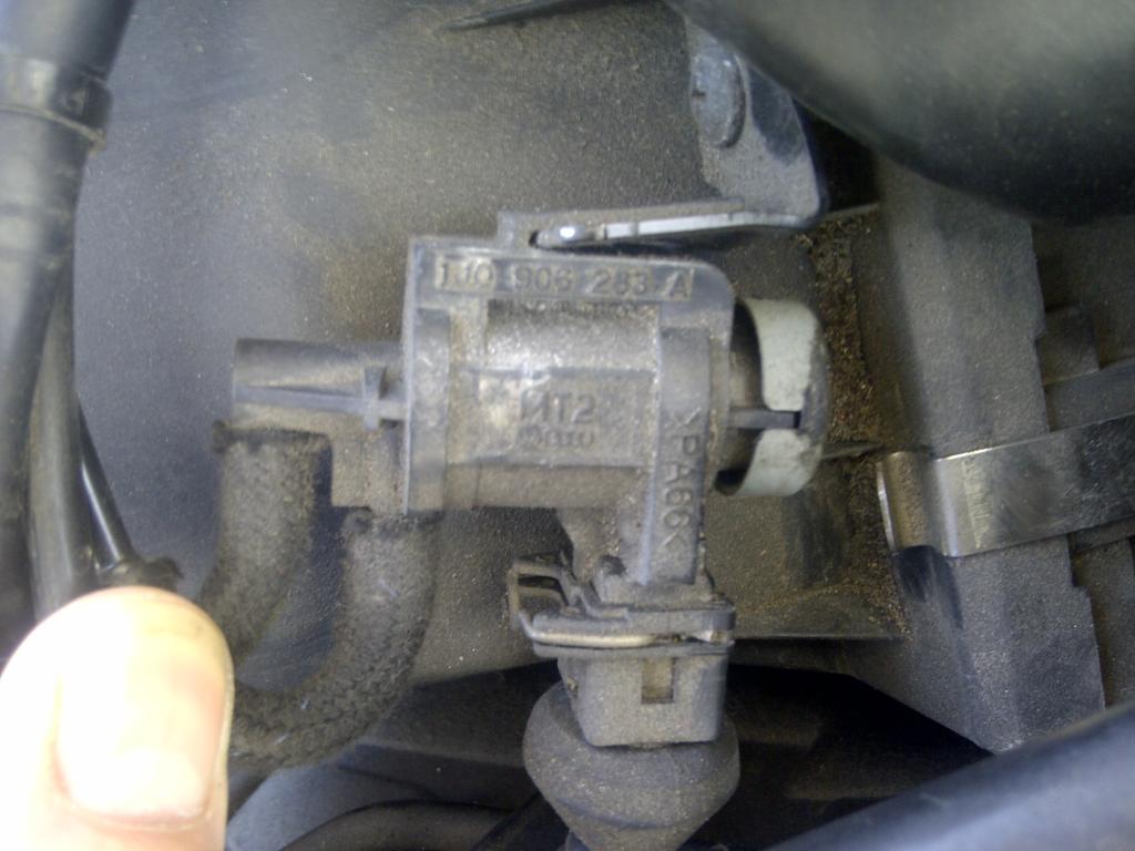

carlparkinson Posted March 18, 2012 Author Report Share Posted March 18, 2012 After the earlier problems i had,im not sure if the maf sensor sorted it out but the emmisions warning and the engine warning lights have not been on for a while but now its idleing rough. When started sometimes its ok but other times it the idle "hunts" up and down like its going to cut out.Every time the idle drops there is a quick hissing noise from i think the N75 valve. Im going to try and replace the N75 valve and see if that works and if any one has 1 for sale that would be a great help. Ive looked on Ebay but cant find any with the same part number as mine,the number is 1JO 906 283 A. Heres an image of what i have. Thanks for any help Link to comment Share on other sites More sharing options...
pontyslapper Posted March 18, 2012 Report Share Posted March 18, 2012 Chances are its been superceded - are the ones you've spotted the same number apart from the A at the end - that usually indicates a superceded part - VW increment the final letter. I have A parts in the past and they were up to J when replacement was needed and looked quite different sometimes, but they mostly fitted! Link to comment Share on other sites More sharing options...
carlparkinson Posted March 18, 2012 Author Report Share Posted March 18, 2012 Cheers pontyslapper Just my look that. Has anybody had to replace this valve with a different part number or know what the correct number is if it has been superceded Cheers Link to comment Share on other sites More sharing options...

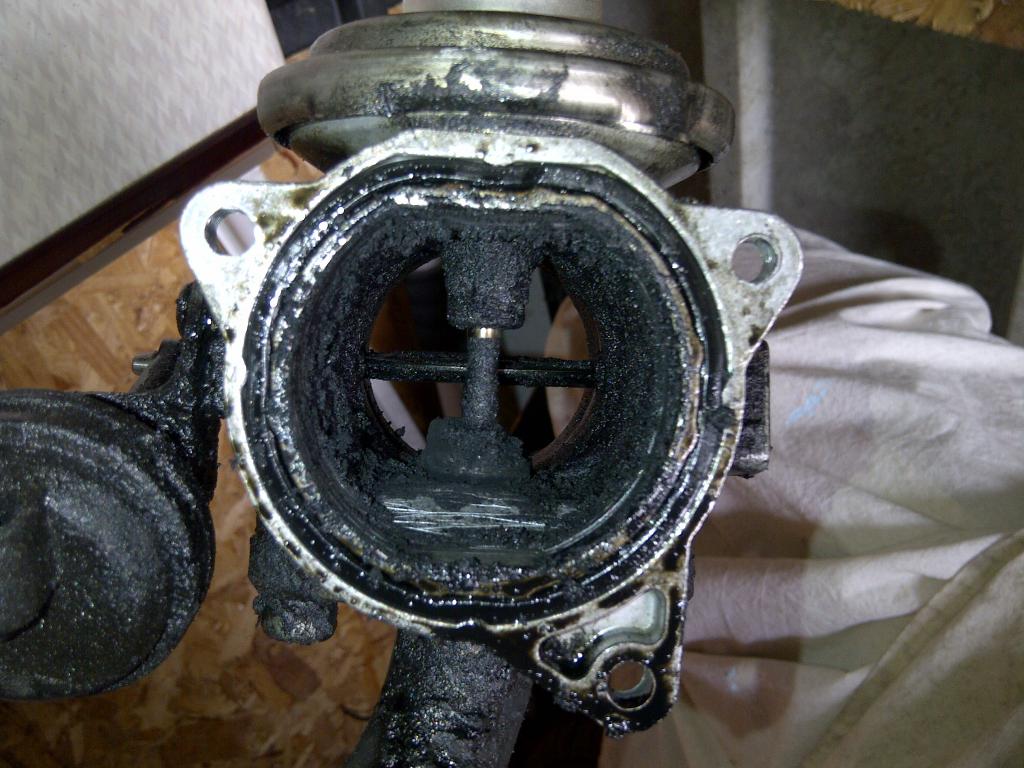

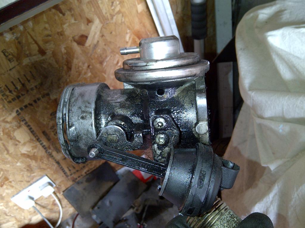

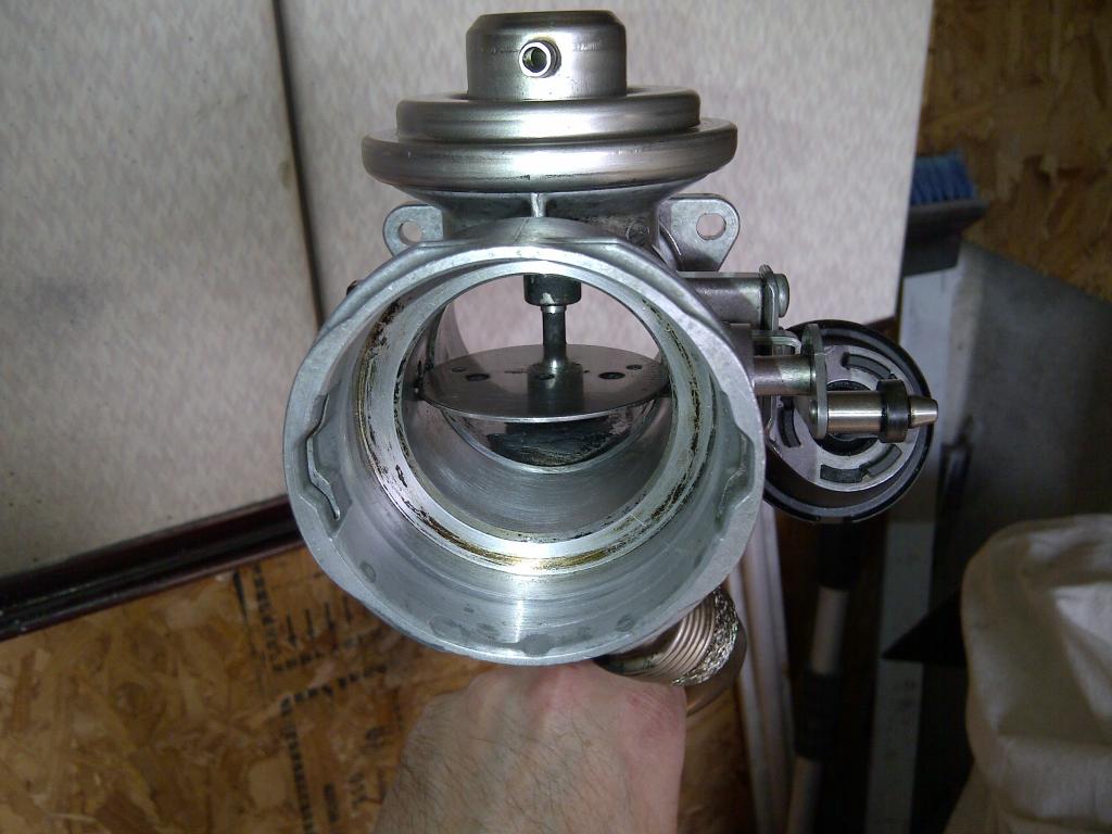

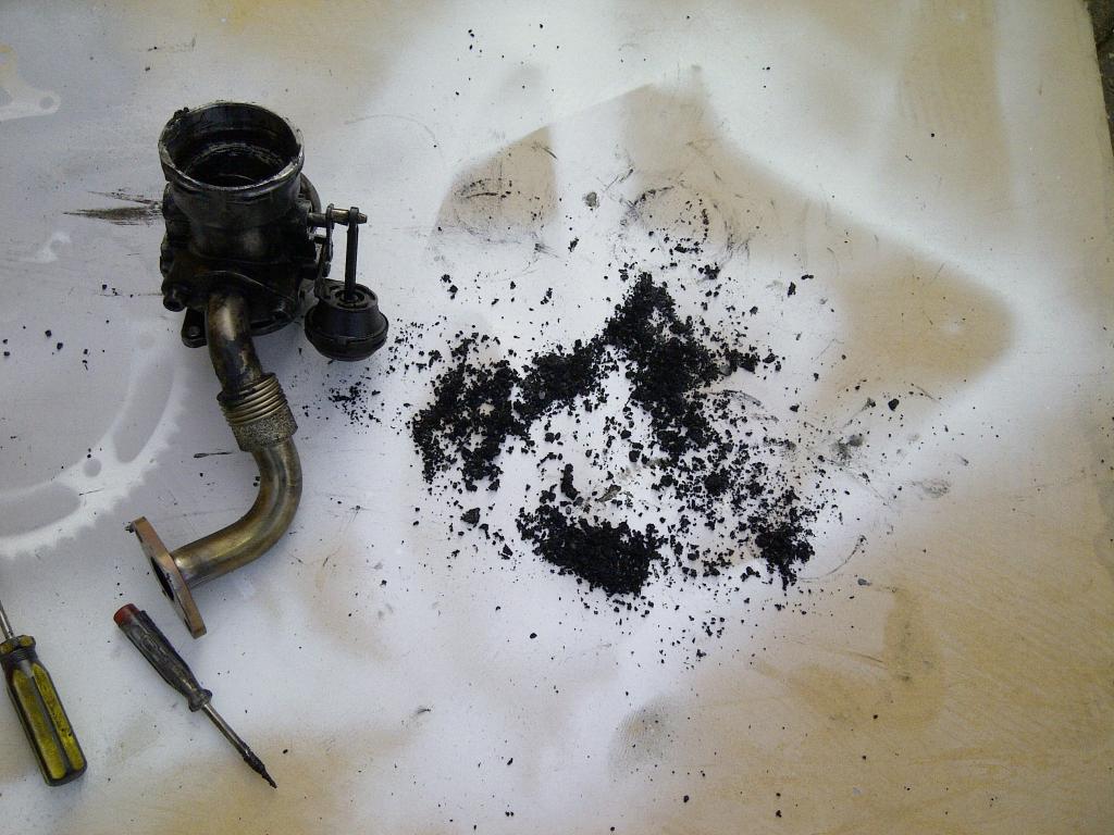

carlparkinson Posted March 24, 2012 Author Report Share Posted March 24, 2012 (edited) Pontyslapper,,,,Checked with VW and the part number is still available although they have to order it. Before i shelled out for the N75 i read on other posts about checking the EGR Valve. I had it out today and it was caked in thick carbon and had oil all over it,found my problem.Gave it a good clean and put it back on quess what still the fecking same. Just to clarify it has a lump in the tickover about every 10 seconds,the revs drop about 500 rpm then go back up again although it drives ok when i lift the revs with plenty of power. I did try dissconecting the tube from the N75 valve that has the little 1way valve in it and it stopped the rough idle but the engine changed note and didnt drive properly having loads of turbo lag so connected it again. I have read about the injector loom causing similar Am i right to now start thinking about changing the N75 valve. (This is doing my head in now) Carl Edited March 24, 2012 by carlparkinson Link to comment Share on other sites More sharing options...

carlparkinson Posted March 26, 2012 Author Report Share Posted March 26, 2012 Not read them yet.what I did notice though,when I pull the rubber pipe off the egr valve the idle goes perfect,although this bings up the emmissions light up.is there a way I can check tjhe egr valve. Link to comment Share on other sites More sharing options...
cruiser647 Posted March 27, 2012 Report Share Posted March 27, 2012 Presume the pipe is OK and clean? So it might be a vacuum issue? I think that pipe is probably a vacuum tube? Link to comment Share on other sites More sharing options...

carlparkinson Posted April 18, 2012 Author Report Share Posted April 18, 2012 Well over the past few weeks ive changed the N75 valve and bought a new EGR valve,all pipes are ok. But tonight i had my fingers in the inlet side of the turbo and turned the vanes which seemed stiff and scratchey if you know what i mean. When i rev it hard the turbo can be heard spinning but it whistles when i let my foot off the pedal and sounds dry/stiff. Ive also noticed oil coming from the holes in the EGR Valve. How big a job is it to remove the turbo and clean it? Are they hard to strip down and rebuild or can anyone suggest a good recon firm.The car is used daily so need to do it in a coulpe of days if possible. Will i have new gaskets to buy/order etc and are there any special tools needed. Really need help on this one please. Carl Link to comment Share on other sites More sharing options...
