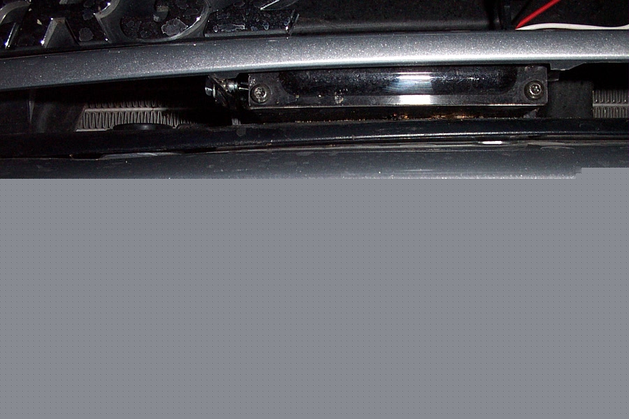

myst Posted June 1, 2004 Report Share Posted June 1, 2004 Joe, I fitted a Blinder M-06 to my R32 a month ago. Superb piece of kit! Saved my bacon twice in May. Dead easy fit. Lift the bonnet & pop the grille out (No tools needed) The two jamming heads will fit perfectly in the bottom section of the grille. You will have to cut away a small piece of plastic on both sides (I used an angle grinder!). Wire the negative (black) direct to the battery. The positive wire should be routed along the RH wing, following the bonnet release cable, into the cabin. Connect it to a switch & run a second wire back to the + on the battery. The M-06 is actively jamming at all times when powered on. It does NOT have any indication that U have been illuminated so a Radar/Laser detector is also desiable. You need to know if a laser gun is on you so as to hit the brakes & turn the jammer off......... Mikey Link to comment Share on other sites More sharing options...

myst Posted June 2, 2004 Report Share Posted June 2, 2004 Joe, I was targetted by a "safety van" & a motorcycle copper. I was way over the limit but I can safely say that the mandatory 14 days have passed & no ticket. M0-6 is a super piece of kit but you must ensure that u wire it to an illuminated on/off switch. It doesn't use much power (400mamps I believe) & I have inadvertantly left it switched on in the garage overnight several times but the car has always started. As far as I am aware, the MO-6 is identical to the M-20, but without the audio. I run a Bel 745Sti. IMO the Bel products are the best "active" receivers on the planet. I don't know how to post photo's on TSN so if you PM me with your email address I'll be happy to send 4 pics of the jammer head positions & wiring. Cheers, Mikey Link to comment Share on other sites More sharing options...
