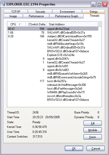

Mollox Posted September 20, 2005 Report Share Posted September 20, 2005 My pc has suddenly started running uber slow in the last couple of days. Even just ticking over with nothing running, Task Manager is showing Explorer.exe as constantly above 90% CPU use - often 97/98. What the feck is going on? Just done a full norton scan and it identified a couple of potential adware threats but nothing of any real concern. Any ideas what might be going on or how I can get to the bottom of this? ta Link to comment Share on other sites More sharing options...

skifly Posted September 20, 2005 Report Share Posted September 20, 2005 my lappy often does it - usually at the same time as scan32.exe is running or shortly afterwards. Kill the process then do the CTRL-ALT-DEL combo and on the Applications tab click the new task button - then type explorer.exe and OK. Fixes it for me. Link to comment Share on other sites More sharing options...
shark_90 Posted September 20, 2005 Report Share Posted September 20, 2005 Sounds like a problem Molly.. first of all ditch Norton and get some decent virus protection - McAfee Enterprise if you can stretch to it. Far superior. What is explorer doing at the times of your problems? Do you have loads of directory trees open? Or perhaps a folder full of pictures/videos which are displaying as thumbnails? Or is it just being poop - which is probably the most likely option. Link to comment Share on other sites More sharing options...

Mollox Posted September 20, 2005 Author Report Share Posted September 20, 2005 Forgot to mention, I started getting bloody winfixer popups last week but these seem to have gone now. Having a read around the net I see CPU hogging often associated with this piece of malware. I've found a few removal instrucitons on the web but they're all in forums, are fecking complicated (I've removed a lot of crap manually before) and seem to be unique to each user's circumstances. Is there a Win xp test or list of associated files to a) determine I have the winfixer problem and B) a generic set of instructions for removing winfixer? I suspect this could be it.... Link to comment Share on other sites More sharing options...
Chris_B Posted September 20, 2005 Report Share Posted September 20, 2005 If you can be bothered, you could download and run Process Explorer, File Monitor and Registry Monitor from http://www.sysinternals.com/ and see what the explorer.exe process is actually up to when it takes all your CPU. You could also down their rootkit revealer and run it just as another check that you're clean as some spyware/viruses hide from virus scanners. Link to comment Share on other sites More sharing options...

Mollox Posted September 20, 2005 Author Report Share Posted September 20, 2005 hmm oppml.dll is using all my CPU Google doesn't recognise it either Link to comment Share on other sites More sharing options...
Mollox Posted September 20, 2005 Author Report Share Posted September 20, 2005 killed it and we're working better already. Still don't know WHAT it is, what's causing it or how to properly remove it though I also suspect tusst.dll of being dodgy Cheers for the Process Explorer link btw Chris Link to comment Share on other sites More sharing options...

Mollox Posted September 20, 2005 Author Report Share Posted September 20, 2005 I'm pretty sure its winfixer... oppml.dll is a randomly created filename by the fecking malware - no wonder google can't find it. Can I be bothered to run through the process tonight though...hmmm Link to comment Share on other sites More sharing options...

Mollox Posted September 20, 2005 Author Report Share Posted September 20, 2005 OK, flying again now If you get a popup that looks anything like this and mentions Winfixer then you're infected with a very annoying and resource-sapping piece of ad/malware. Let me know and I'll show you how to get rid of it Link to comment Share on other sites More sharing options...
