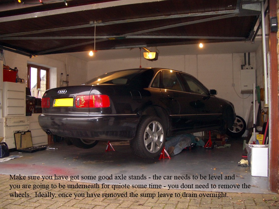

fudge Posted February 16, 2006 Report Share Posted February 16, 2006 Further to my last post and as suggested by my son NikW some pictures: (1) You need some good (and strong) axle stands - you are going to be under the car for some time. (2) This is why you need to change the oil regularly. You MUST use the special Audi oil available from Stealers in 1 litre or 20 litre packs. Also available from http://www.lubricants.org/?path=item&id=378 only in 20 litre packs (Esso ATF 71141 which is what the Audi oil is) quite a bit cheaper. Do NOT use any other oil. It is not red (as many ATF oils are). My Merc 500SL uses the red variety of ATF oil and was still clean red when changed at 45K miles). Furthermore you cannot check the level or refill from under the bonnet. (3) There are 2 cross-members on the S8 which need to be removed - you cannot manoeuvre the oil pan past them. (4) This is what the pan looks like when you get it off. You will see that the magnets on mine were clean - but so I would hope after only 45k miles. You can also see that the oil drain plug is not at the lowest point; if you dont take the sump off you leave more dirty oil behind. The filter change is important; if it becomes even slightly blocked you will get problems. In my view, based on helping do the job on 2 cars, there is no substitute for dropping the sump and changing the filter. I dont understand how you could do a pressure flush and, on the evidence of my son's box at 85k miles there was quite a lot of sludge which flushing is not going to remove from the magnets. S8ed was surprised that a newbie produced what he (kindly) described as a "top" post. The reason is easy; if I believe I have something worthwhile to say, I post. Otherwise I just watch with interest and (sometimes) amusement. I have been a car nut (or is it geek) all my life and this is by far the best enthusiasts car forum I have come across. The A/S8 forum is one of the most active. Is that a reflection of the enthusiam and interest of the owners or do we have more problems than most? I hope that it is the former. For what it is worth, I belive that ATF oil changes without a filter change are a false economy. Exactly when such a change should be done is a matter of opinion, my money is on 40 to 50 k miles but I suppose you could do just an oil change at 25k and then drop the sump and change the filter at 50k if you wanted to play safe. Bearing in mind what a gearbox costs and the number of people who have had problems, I dont think we can simply follow Audi's advice and see it as a "lifetime" fill unless we wish to further increase the stealers' profits. Link to comment Share on other sites More sharing options...

fudge Posted February 16, 2006 Report Share Posted February 16, 2006 It would appear that I cannot attach multiple pictures to my last post - you have only got number(4) attached is (1) Link to comment Share on other sites More sharing options...
fudge Posted February 16, 2006 Report Share Posted February 16, 2006 It would appear that I cannot attach multiple pictures to my last post - you have only got (4) attached is (2) Link to comment Share on other sites More sharing options...
