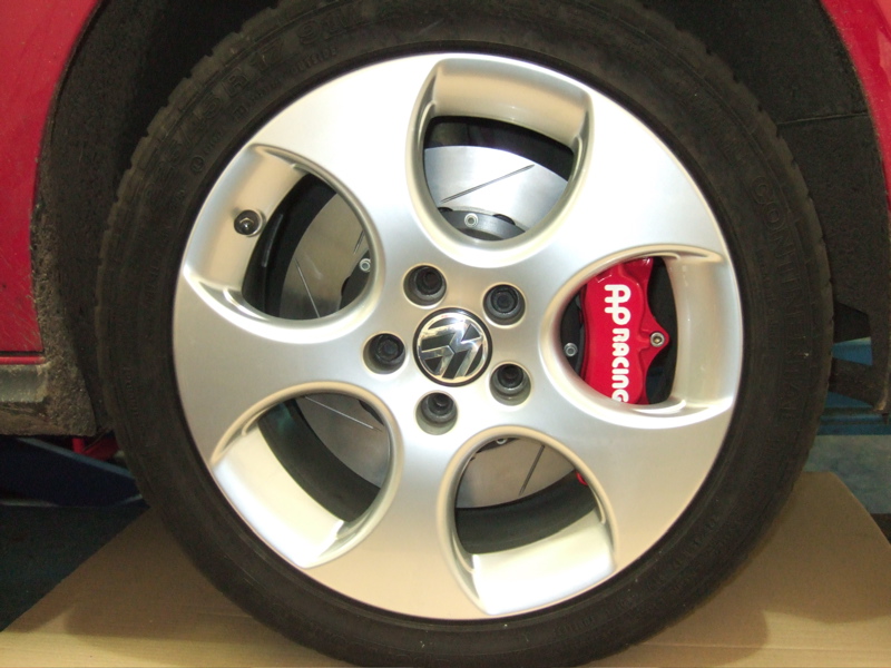

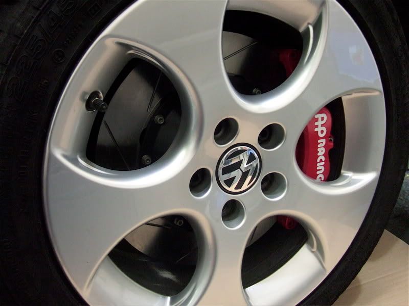

Hmm....My understanding is that it's things like braided hoses with high performance fluid and the appropriate pads (Ferodo DS2500 are now well established) which can make the difference in brake performance. Drilled discs can be a problem but I don't think that AP Racing would agree with you about their groove design being a problem - IIRC there are also other factors involving the disc construction.
My AP brake kit has been designed for fast road use rather than for full competition. I have now spent two full afternoons with AP's Senior Engineer and been given a very thorough tour of their premises and I am totally confident in their products. This team is at the cutting edge of brake and clutch products for F1 and have been for many years and with most of the leading F1 teams.
I'm not saying that AP Racing are the one and only good brake producer but they must be amongst the very best. So far, I just can't fault these brakes no matter what I have thrown at them (so far) and I have had three real-world 'moments' where I have felt seriously glad of their very even and effective stopping power. The pedal feel and response is perfect imo.
It should be noted though that I am not a highly experienced racing driver and so my judgement can only be based on road driving and neither am I trained. I do have years of very focussed driving experience though and am offering opinions based on comparisons with the GTI OEM brakes.

So, you've got exactly the same AP brakes as me? Fronts only? I noticed my wheels getting dirtier more quickly! Brake dust.
The Ferodo DS2500 is very highly thought of for fast road use and occasional track days even. It's also important to match the right pad with the disc - Too many 'boy-racers' think that just having drilled discs and racing pads is the answer to brake performance. The choice of fluid is important too.

Its says formula kit for MKV on box and looks the same as your's.Had them fitted at morego and they ordered them for me.
Couldn't agree more the Ferodos are very good had them fitted to a subaru in the past and was impressed.
I've got a DSG with MF wheel and yes I do like the Morego 250. Didn't have the APs done at same time as the re-map but felt they were a good idea!
You have done it the right way round, brakes are always the best mod.The APs really are an amazing piece of kit. Didn't realise they were lighter than standard.
