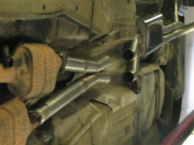

Botang Posted March 23, 2007 Report Share Posted March 23, 2007 The X pipe was designed by a nascar team, the principle is that the two pipes meet in the middle then seperate off again (think a scalextric cross over) They designed my x pipe a little different to Sven's, on mine its very shallow, the idea being that the gasses stay on their own side of the system but as they pass by the middle of the X they create a vacuum in the other pipe which sucks the gasses out of the combustion chamber and the cycle repeats itself. In nascar which has very controlled engines it produced a big difference in horsepower, ive got a video somewhere ill dig it out. Link to comment Share on other sites More sharing options...

NickGUK Posted March 24, 2007 Report Share Posted March 24, 2007 Hi, Thats a nice bit of welding !! What i would like to know is, has anybody compared it to 2 seperate tubes from front to back ? I can understand the vacumn thats created by the exhaust gases rushing past the outlet of the opposite side, but, the gases at "some" point must "collide" there fore slowing it down momentarily... i can only assume that the Nascar team looked into this when they came up with the idea.. Bye for now Link to comment Share on other sites More sharing options...
Botang Posted March 24, 2007 Report Share Posted March 24, 2007 [ QUOTE ] i can only assume that the Nascar team looked into this when they came up with the idea.. [/ QUOTE ] Thats right, on Svens one which was done first this would happen, when I came to get mine done they decide themselves to change the design which is why my one is a lot shallower see the bottom of the first pic after the cats The two pipes join, but only just, like this one below but mine is even shallower than that The gasses in the exhaust would come down in pulses anyway as the engine doesnt fire on both banks of the V at the same time. Link to comment Share on other sites More sharing options...

johnss8 Posted March 24, 2007 Report Share Posted March 24, 2007 Dan, if i remember correctly the Milltek had got a )( as the 1st section, if i can get under the car I'll check for you mate. Link to comment Share on other sites More sharing options...

Lusso Posted March 25, 2007 Report Share Posted March 25, 2007 The milltek cat back system has two seperate pipes running into the centre box the same again into the rear box and out in twin pipes. Hope this is of help. Link to comment Share on other sites More sharing options...

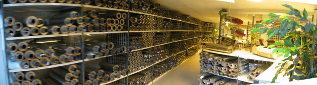

Botang Posted March 25, 2007 Report Share Posted March 25, 2007 To be fair I presume most places that deal wth custom exhaust wont have their own benders they will just buy in variou different bends and weld them all together. On saying that theres not really any excuse for bad welding, as you can see on Svens X pipe the EPS guys were very very good at what they do. Link to comment Share on other sites More sharing options...

Botang Posted March 25, 2007 Report Share Posted March 25, 2007 All I mean is that (in relation to Rob's comments about routing) Powerflow and the like maybe limited in the routing of the system because of the outlets of their silences, the size of their silencers, and the variety of bends that they have in stock. A small selection of EPS stock (they had a number of rooms like this) Link to comment Share on other sites More sharing options...

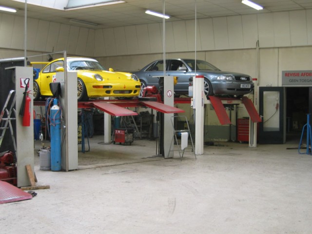

Botang Posted March 25, 2007 Report Share Posted March 25, 2007 Just one more picture Porsche Link to comment Share on other sites More sharing options...
