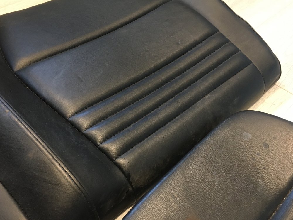

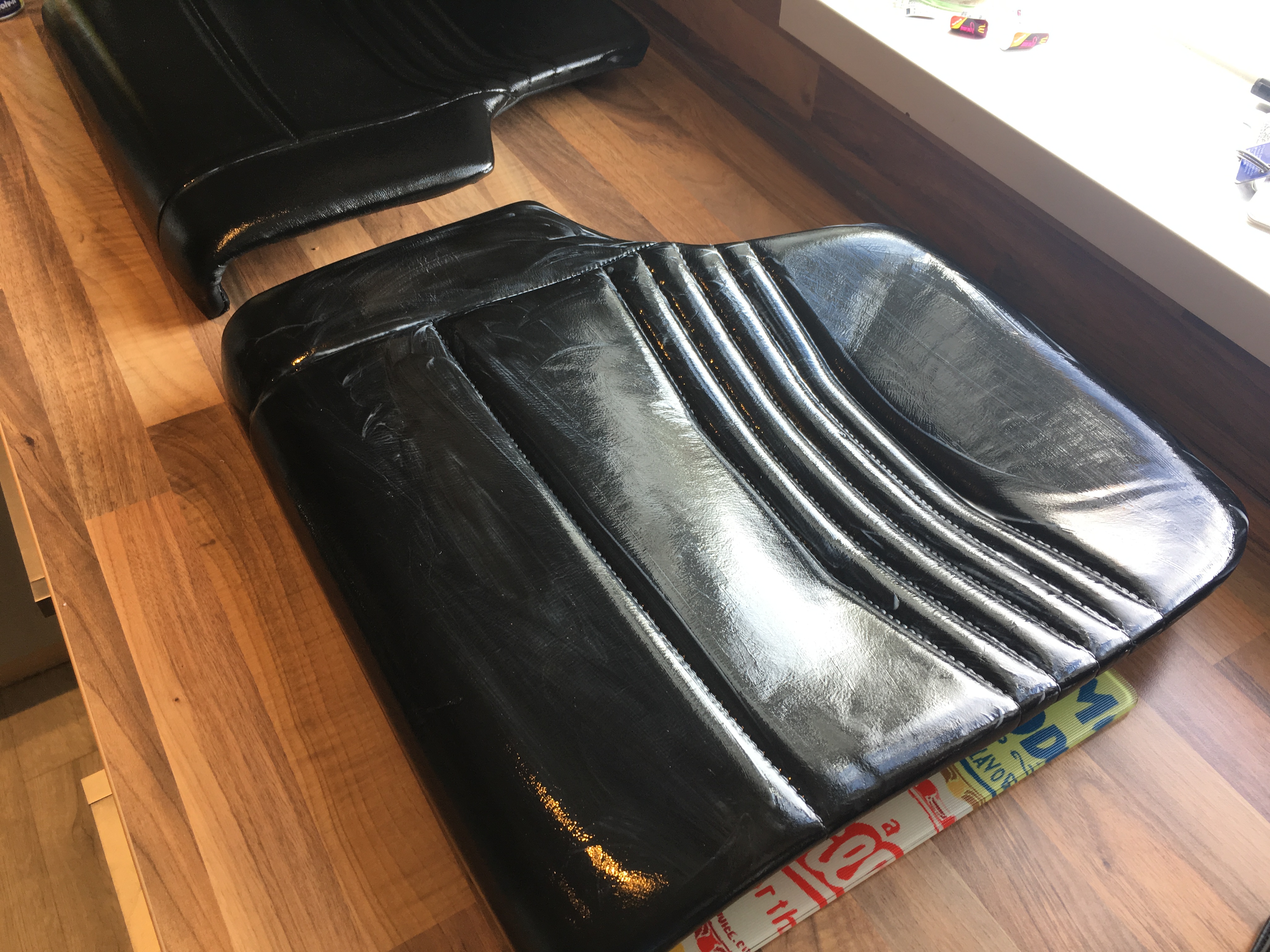

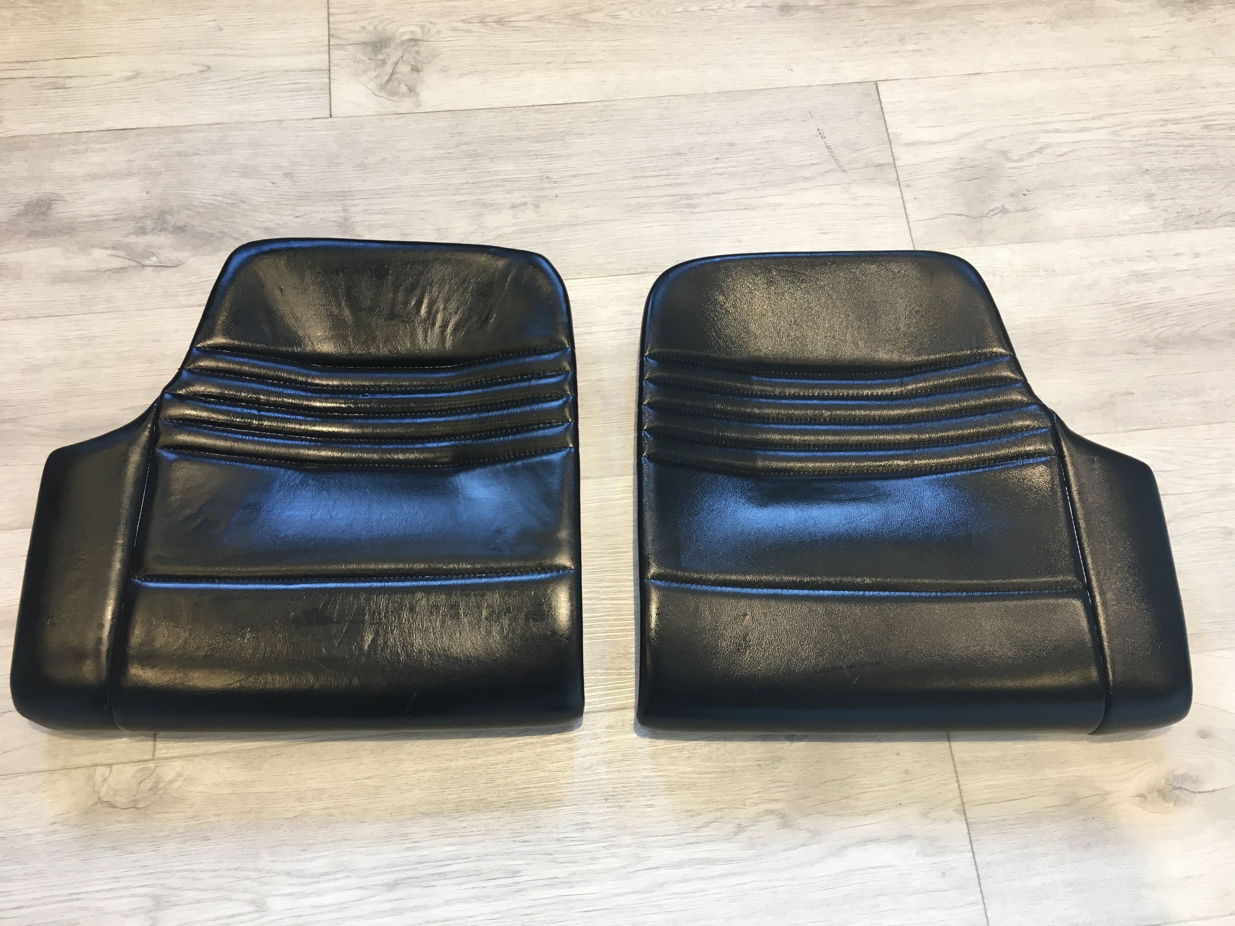

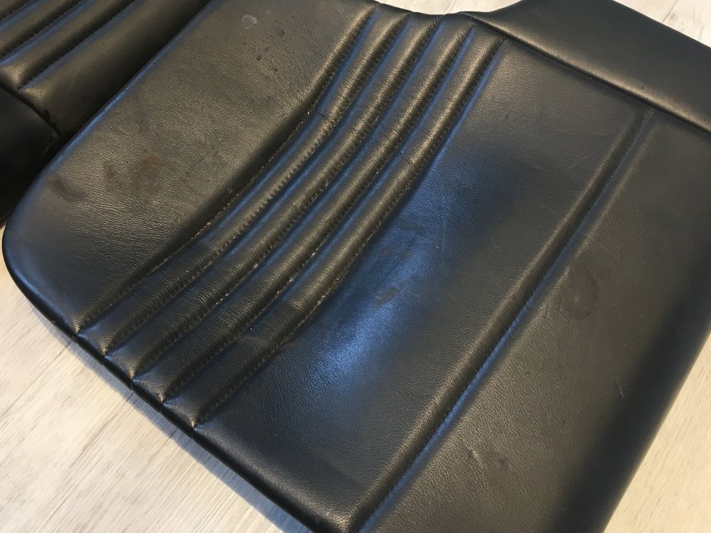

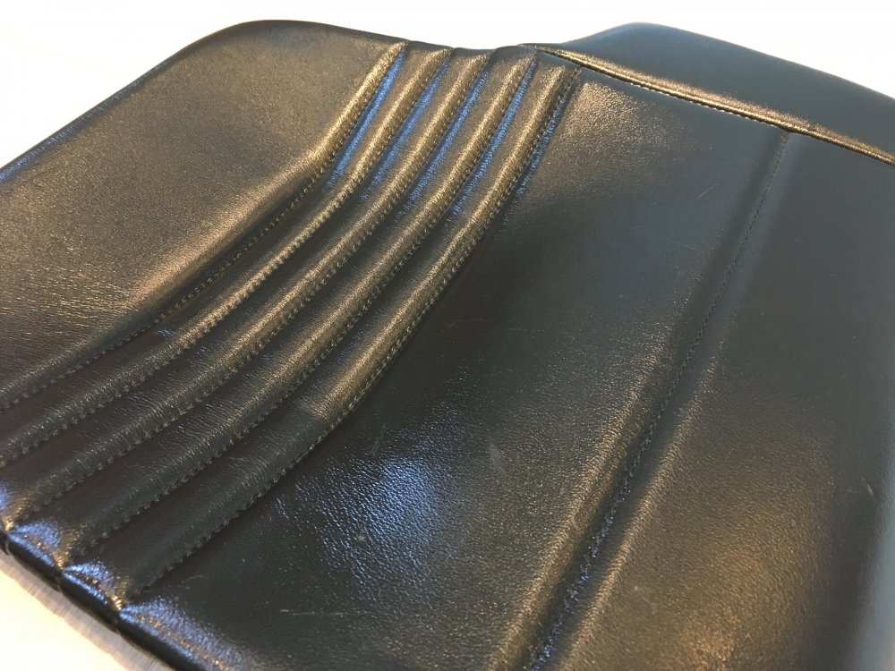

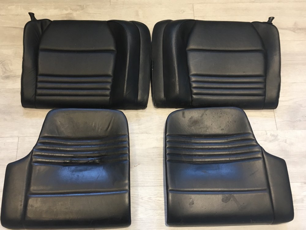

eldavo69 Posted April 18, 2018 Author Report Share Posted April 18, 2018 Picked up the replacement rear seats, they were filthy and sticky, etc. Factored that into the price and got to work. The blue on the seat bases is the reflection of blue skies through the kitchen windows - wow! Link to comment Share on other sites More sharing options...
eldavo69 Posted April 18, 2018 Author Report Share Posted April 18, 2018 They got a proper clean, hot water, microfibres, nail brush, sticky stuff remover gel, Gliptone cleaner and AG Leather Balm (prefer the Gliptone stuff as it’s a less glossy finish but had run out). Very happy with how they came out when given a final buff. Link to comment Share on other sites More sharing options...

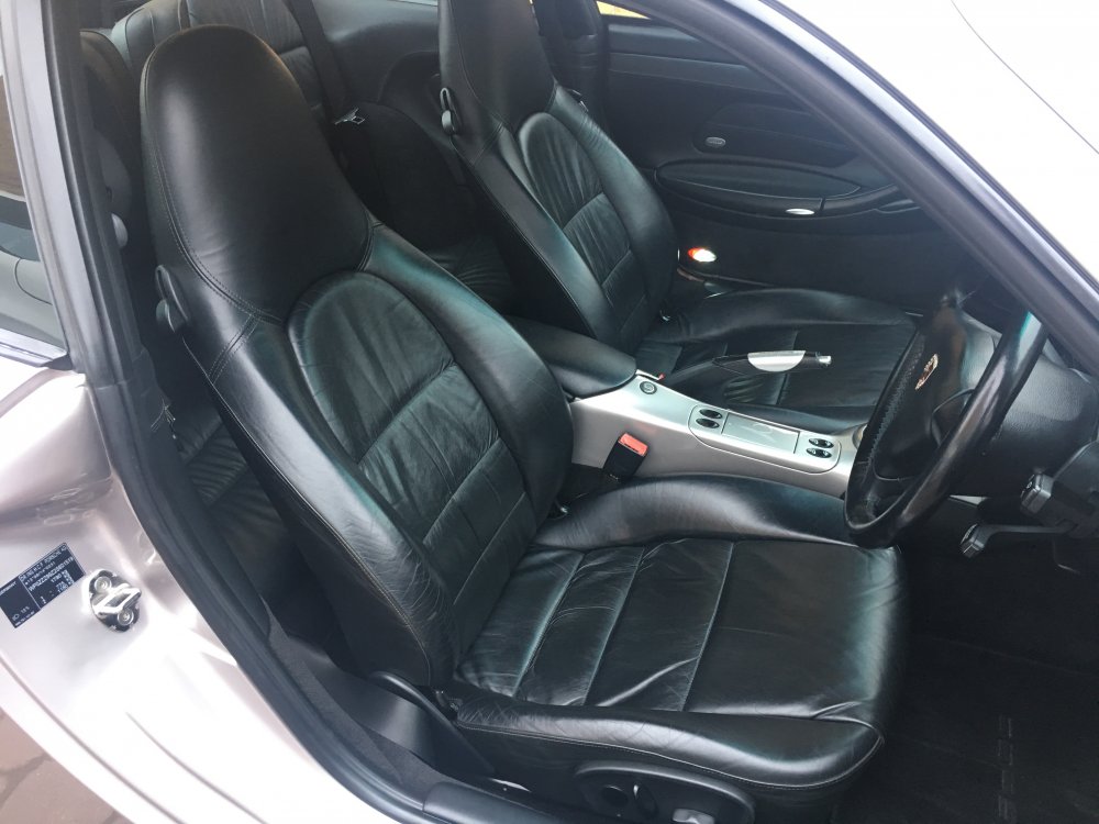

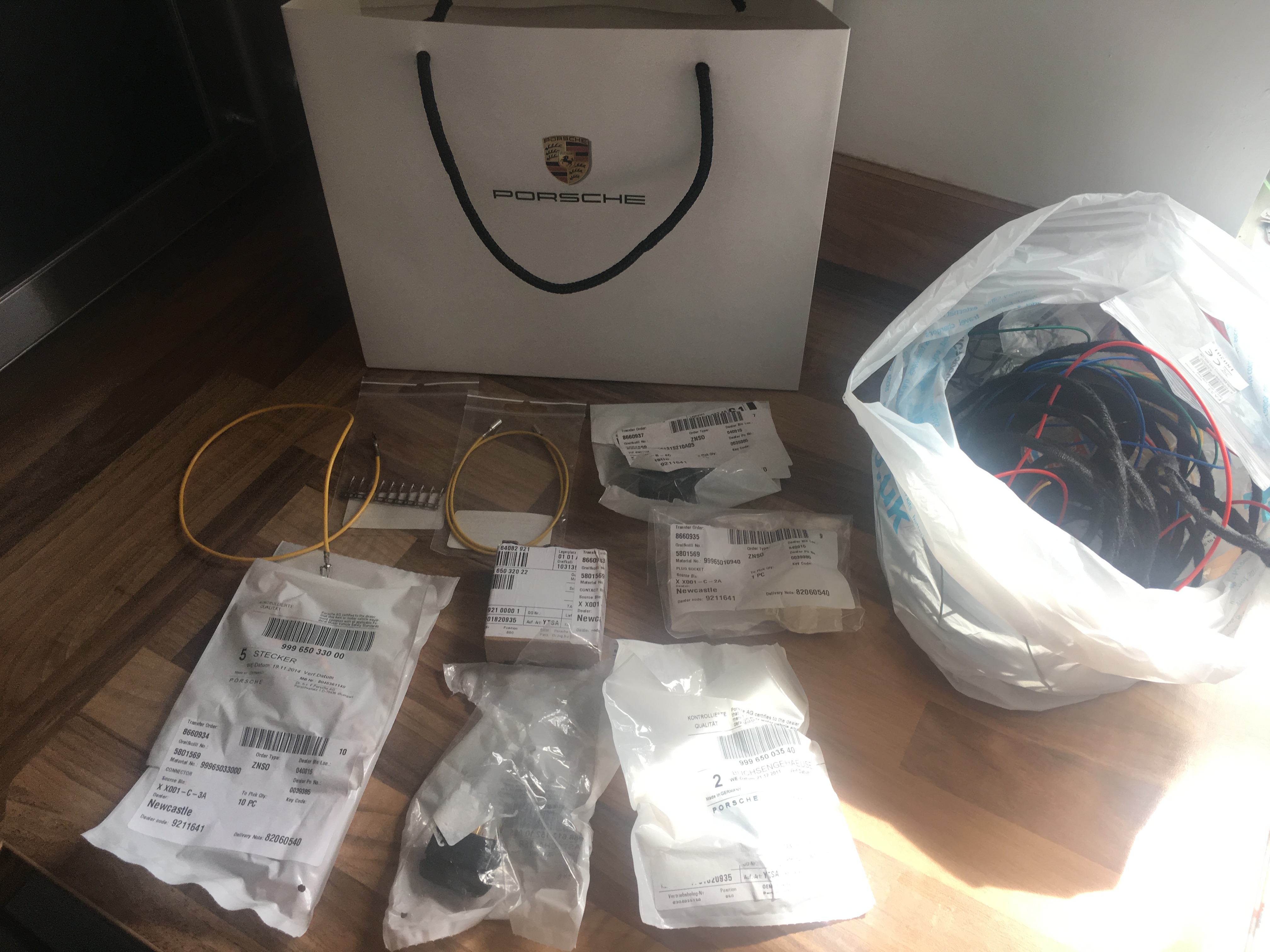

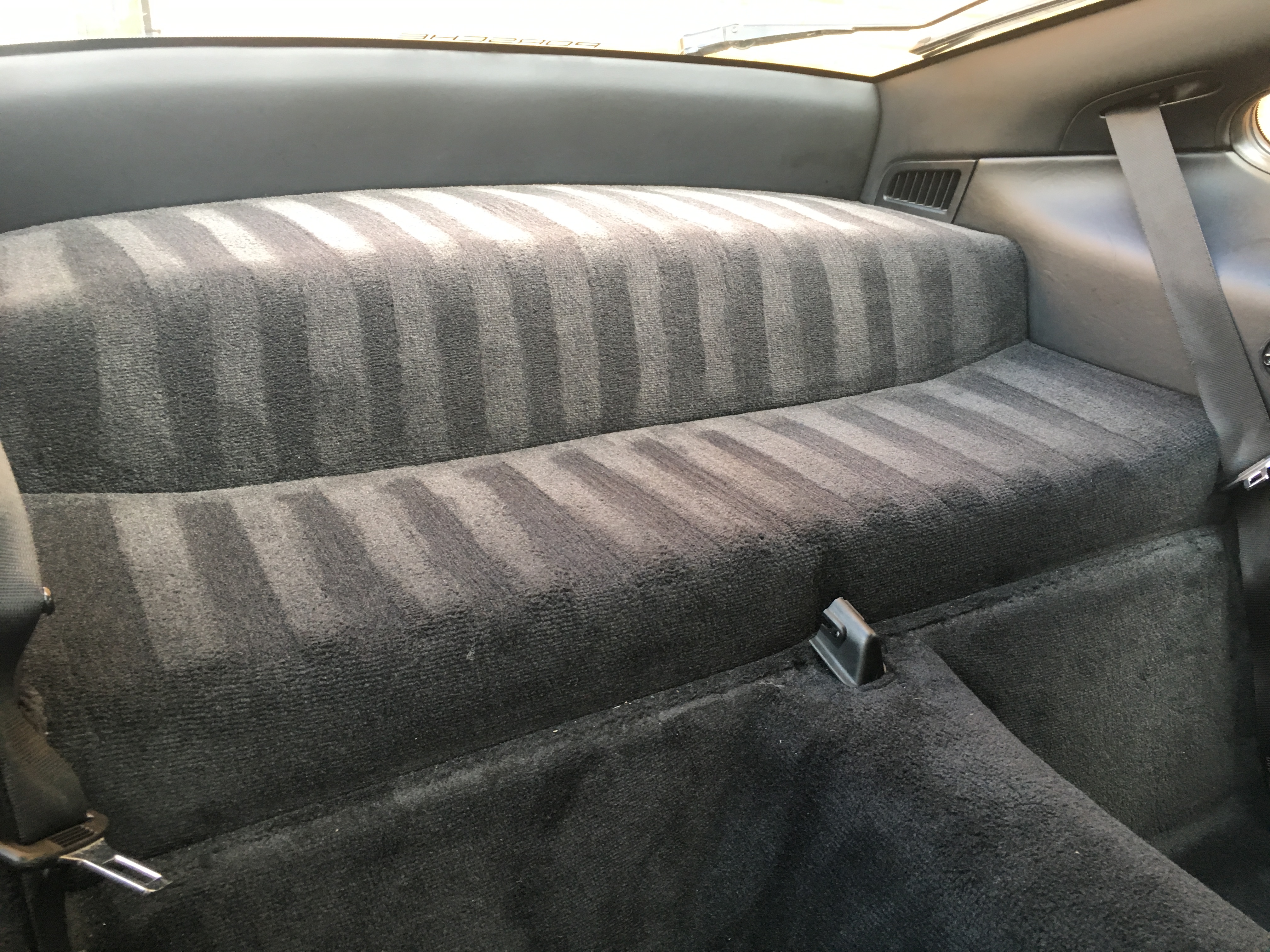

eldavo69 Posted April 18, 2018 Author Report Share Posted April 18, 2018 With the seats out and the nail brush to hand, I couldn’t resist the stripes. I’ve got all the parts for the heated seat retrofit now so am just making up some wiring looms too. Am much happier with the interior, it definitely updates it compared to the ruffled leather. 2 Link to comment Share on other sites More sharing options...

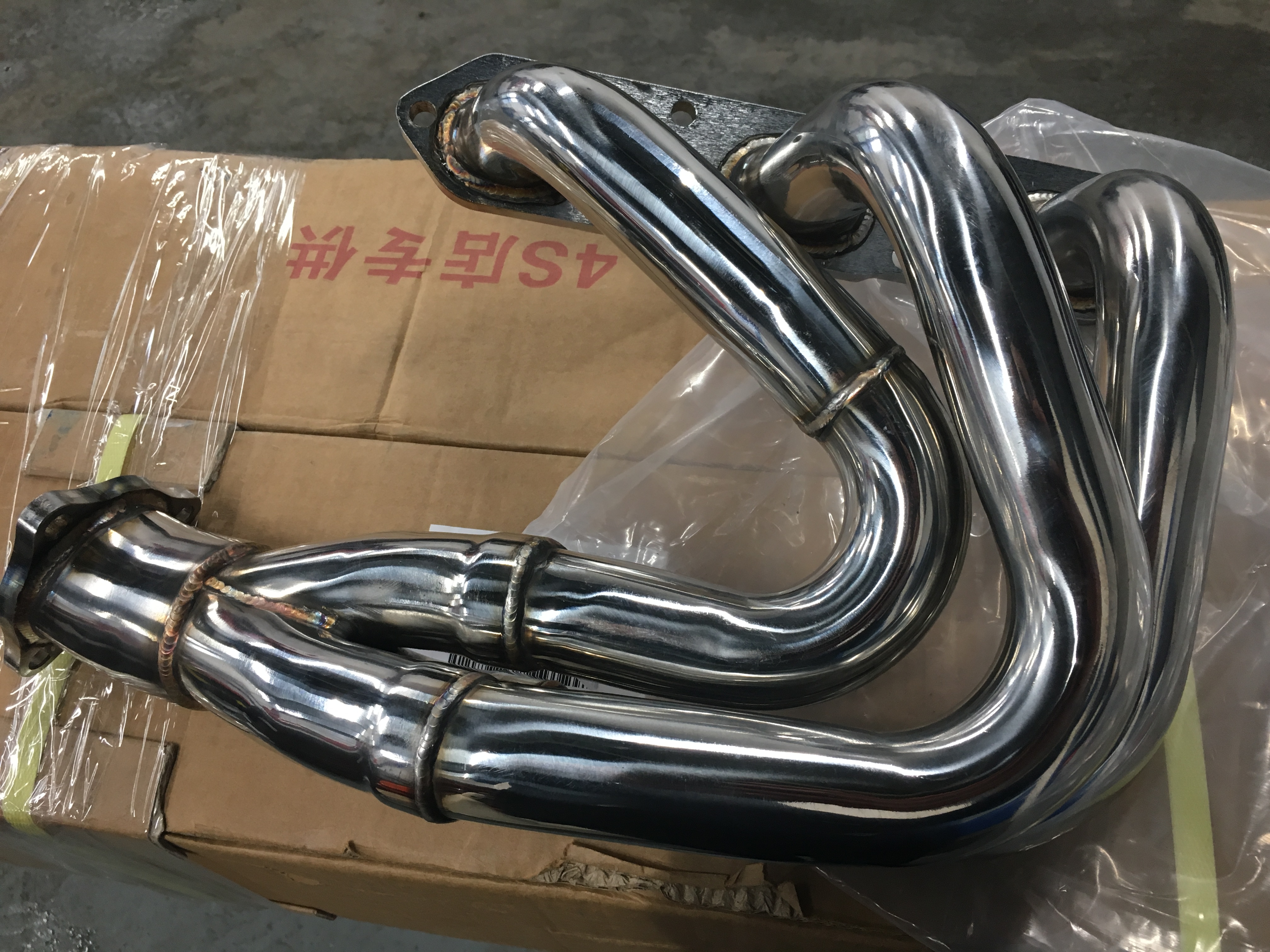

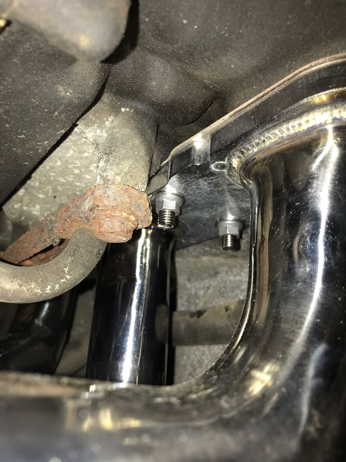

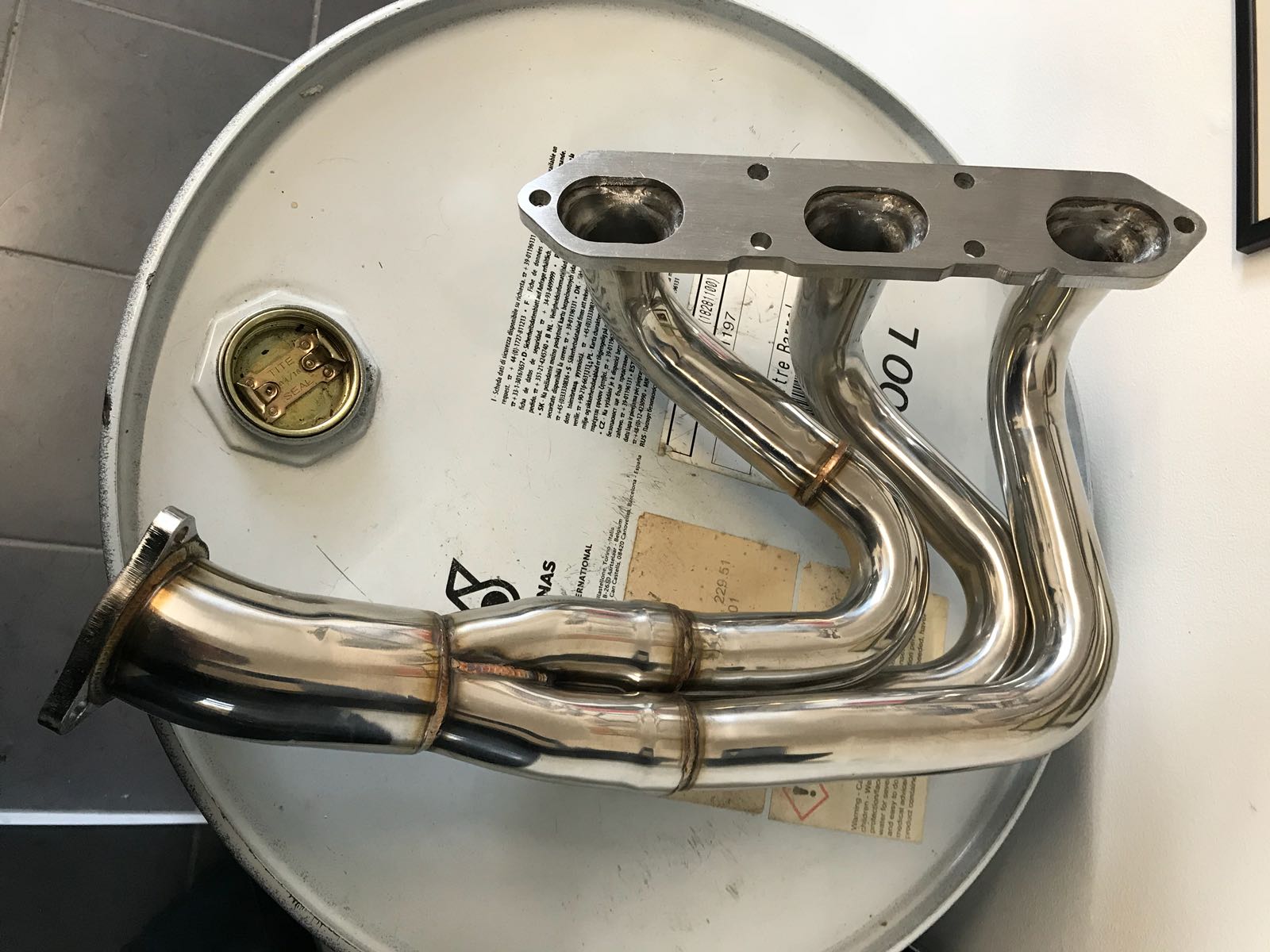

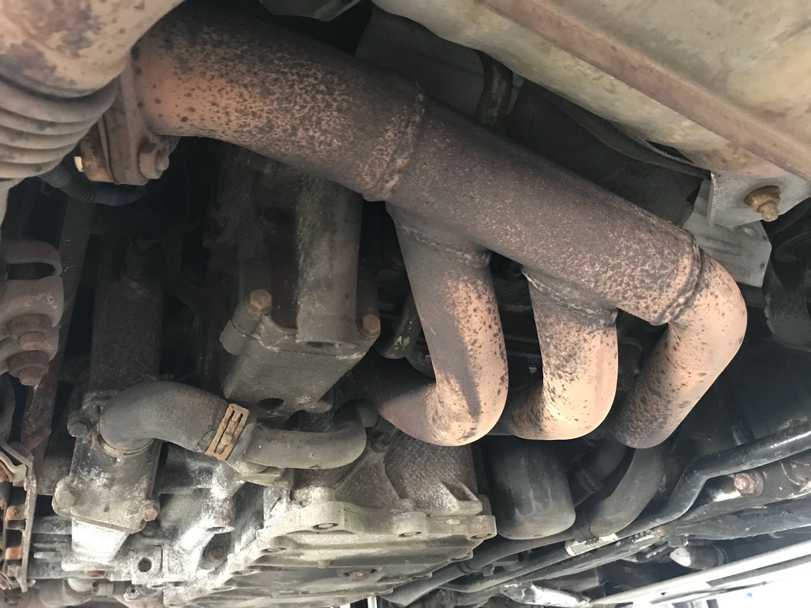

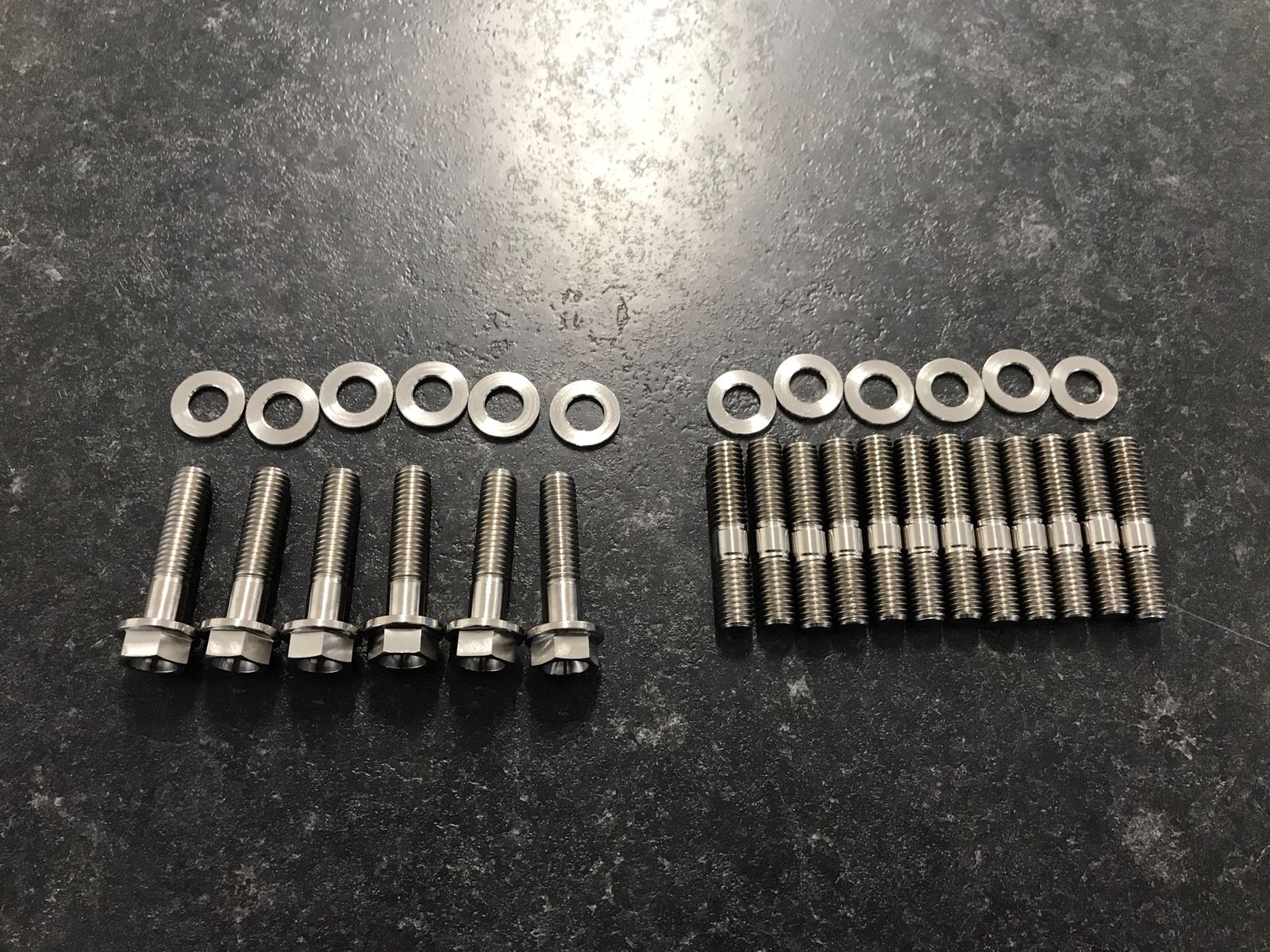

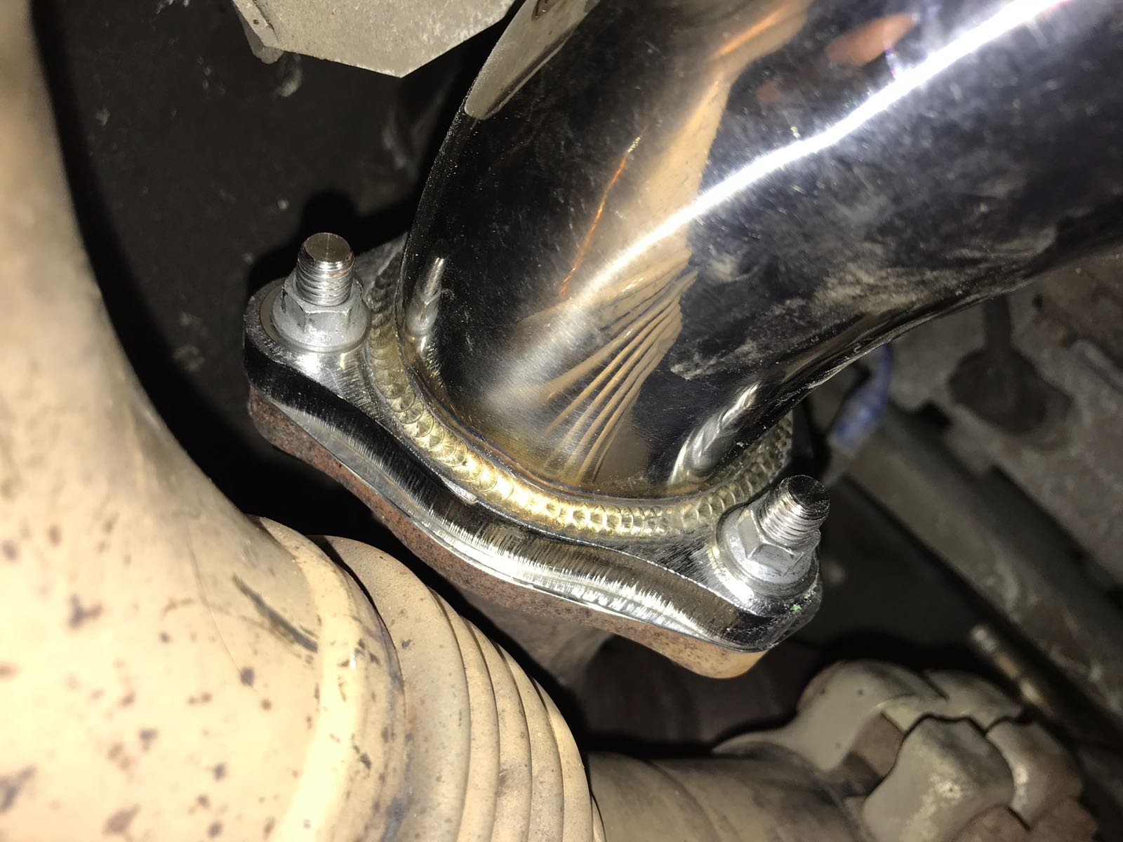

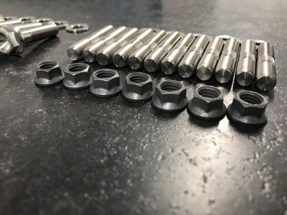

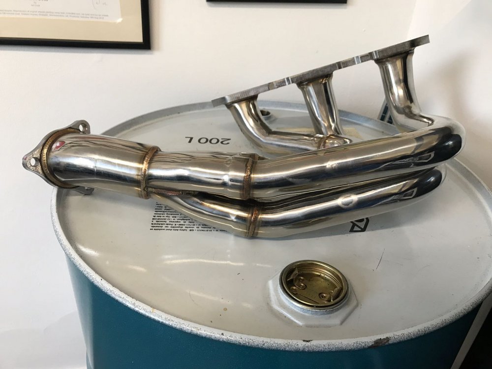

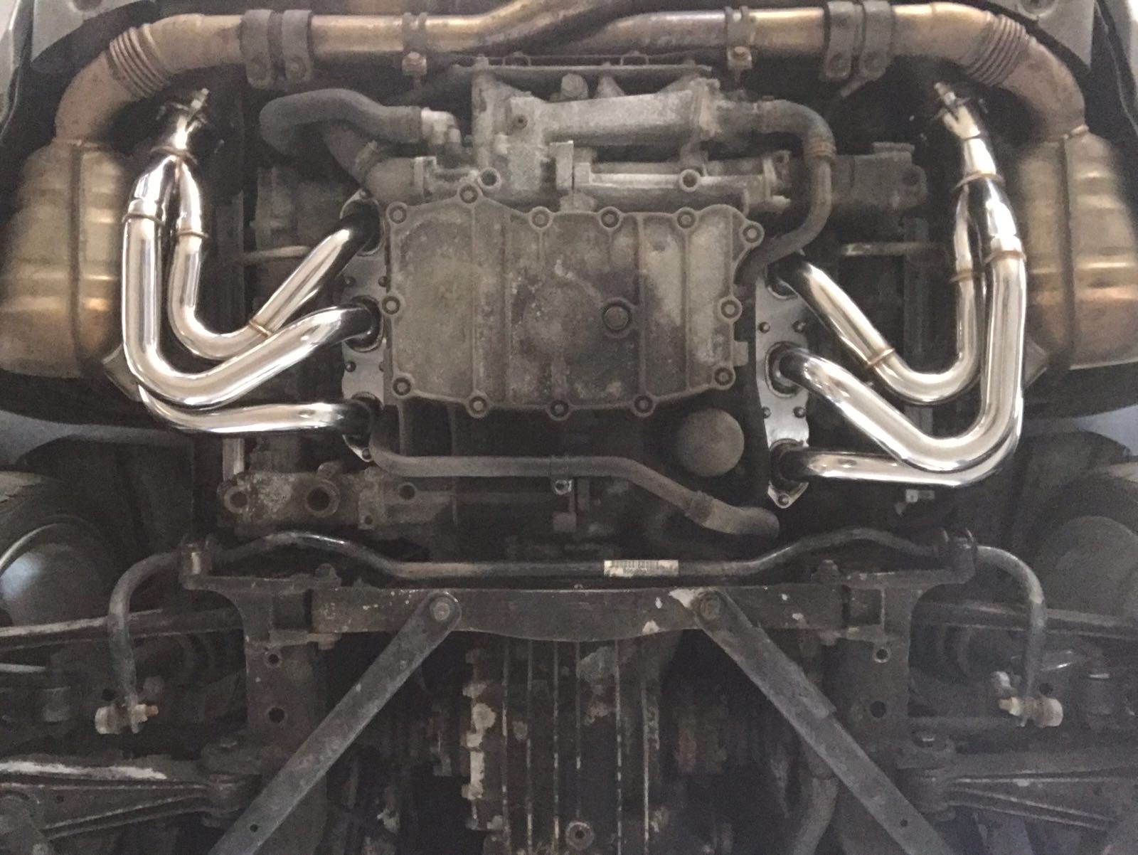

eldavo69 Posted April 19, 2018 Author Report Share Posted April 19, 2018 (edited) The previous owner fitted some 200 cell sport cats and some Dansk Stainless Sport Backboxes. The third and final part of the exhaust system is the manifolds themselves but they’re often a nightmare to fit - out of the 12 bolts holding the 2 manifolds on, it’s common for most (if not all of them) to snap in the head. They then need drilling out and potentially helicoiling - this can end up adding 4-6hours labour onto a 1 hour job. Luckily, when I had the tappets replaced, one of the exhaust manifolds had to be removed and came off with no snapped bolts - so I’m halfway in the clear. I was talking to my Porsche Indys about how people are fitting Titanium studs and K-Nuts to hold the manifolds on rather than the steel bolts. They told me that it’s such a problem for them that they’ve invested £600 in a special drilling jig and kit for removing the snapped bolts and offering titanium fixings as an option would be beneficial for them. They've now sourced a bulk supplier of the titanium fittings and have offered to do my car for the cost of the parts only as they’ll do a write-up and some pictures for their website. Sounds good to me - might as well change those rusty old bog standard manifolds for some nice equal-length stainless ones at the same time right? Being fitted in a couple of weeks. Edited April 19, 2018 by eldavo69 Link to comment Share on other sites More sharing options...

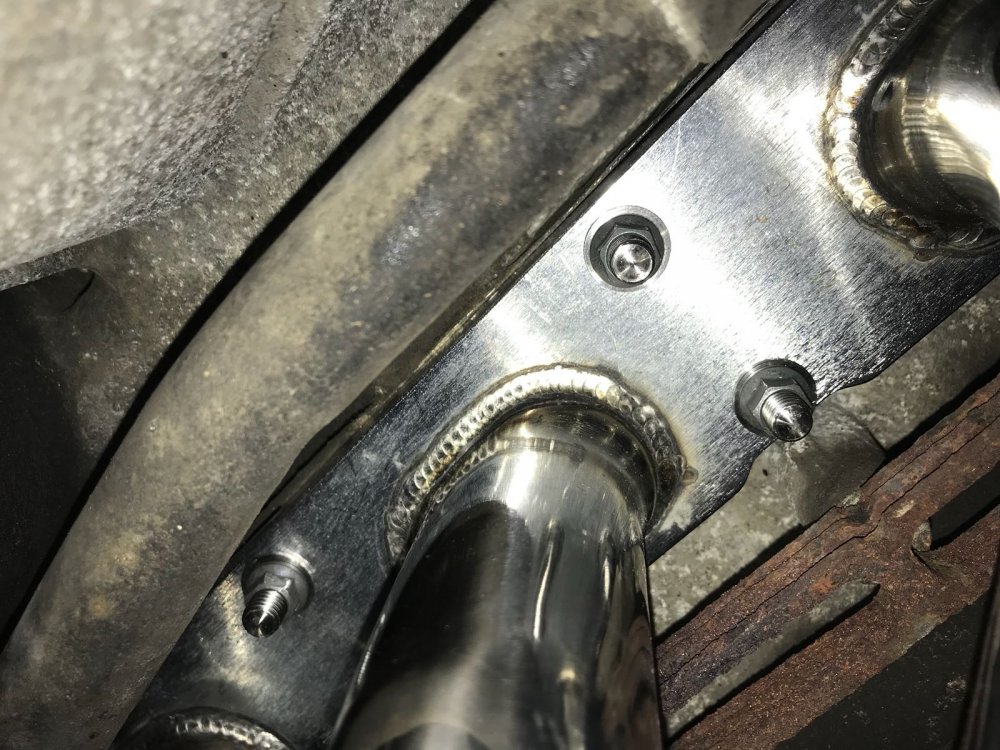

eldavo69 Posted May 2, 2018 Author Report Share Posted May 2, 2018 Dropped the car off yesterday for the manifolds to be fitted. All the titanium hardware had just arrived too. It’s nice and light - predictably. It shouldn’t resemble Spongebob’s Door Knocker after 5 minutes either! Link to comment Share on other sites More sharing options...

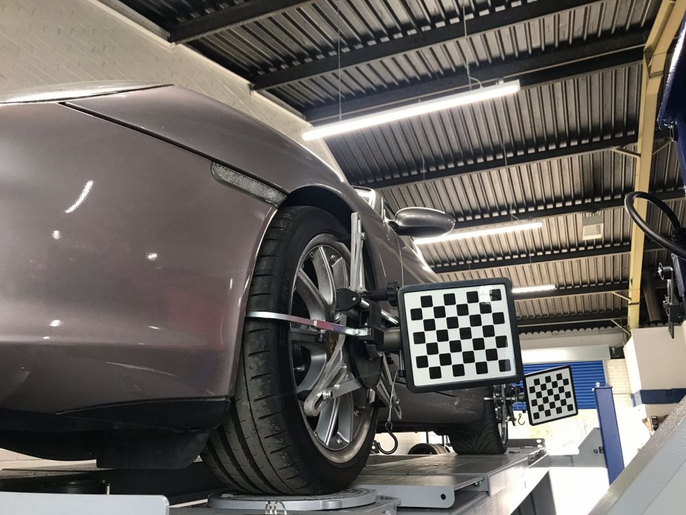

eldavo69 Posted May 3, 2018 Author Report Share Posted May 3, 2018 Oh yes - this sounds nice, best way to describe it is a harder edge to the exhaust note under load. No resonance, no drone - I’ve been advised to get a remap to bring everything together, will need to do my research on that as the benefits on a NA engine are slight. Had a wheel alignment done gratis too - a couple of tweaks to bring it into line after fitting the spacers and some potholes. £100’s worth of Titanium studs, bolts and washers with £20’s worth of K-nuts. Link to comment Share on other sites More sharing options...

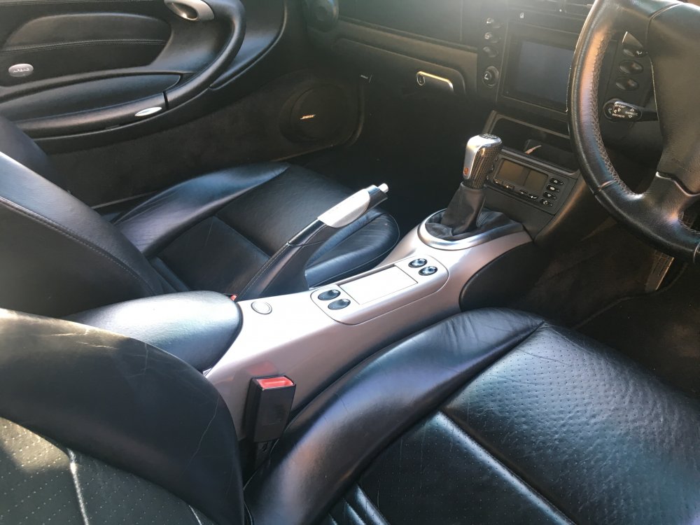

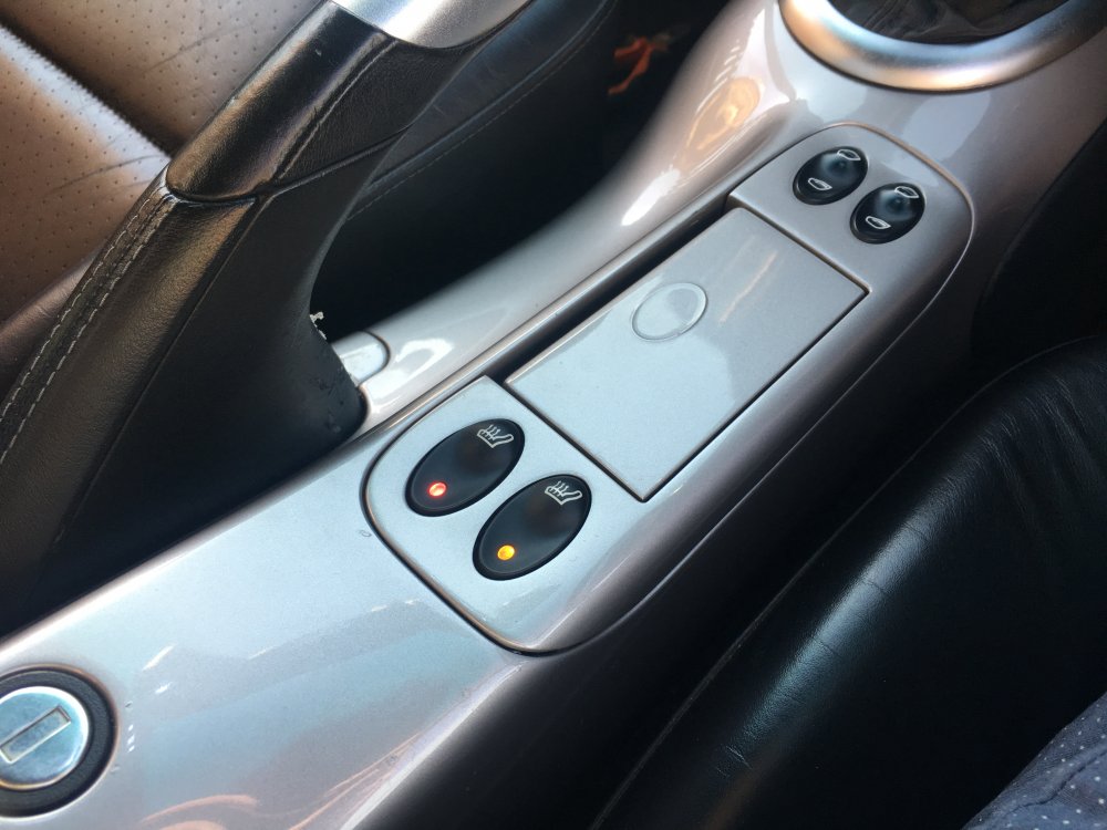

eldavo69 Posted May 7, 2018 Author Report Share Posted May 7, 2018 Managed to get the Bank Holiday afternoon all to myself so set about stripping the seats and centre console out of the car to fit the wiring looms I had already made up for retrofitting the heated seats. The switches are supposed to go in the “batwing” just in front of the gearstick but I wasn’t keen on putting them there. I had considered getting rid of a couple of switch blanks on the “horseshoe” either side of the radio but eventually decided to put them where the rear window switches go on the cabrio. This is where they are on a 986 Boxster so I bought the Boxster parts so that the diagram orientation was correct. Those blanks annoy me more than any others so it seemed a good enough reason to get rid. Install was slow but straightforward, running wiring looms down the sills and under the dashboard meant getting myself in some tricky positions upside down with not much room to work. 6 hours later everything was back together and working for when the weather no doubt goes freezing again shortly! Link to comment Share on other sites More sharing options...
patently Posted May 7, 2018 Report Share Posted May 7, 2018 2 hours ago, eldavo69 said: eventually decided to put them where the rear window switches go on the cabrio. How did you know that's where they go on the cabrio... oh Link to comment Share on other sites More sharing options...

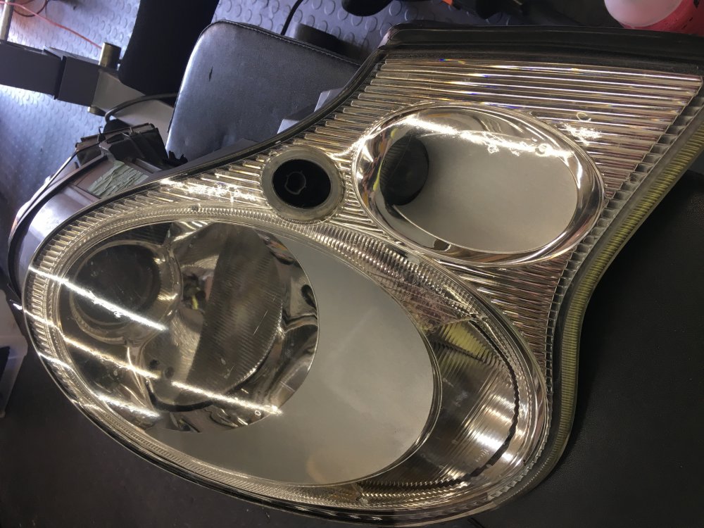

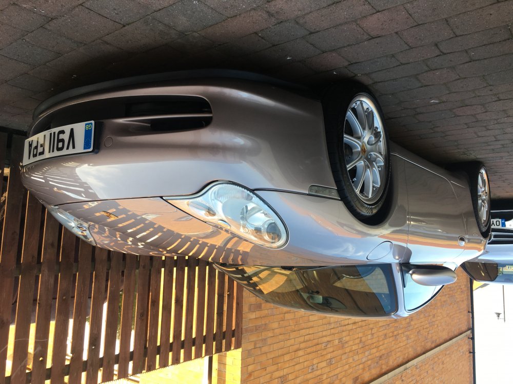

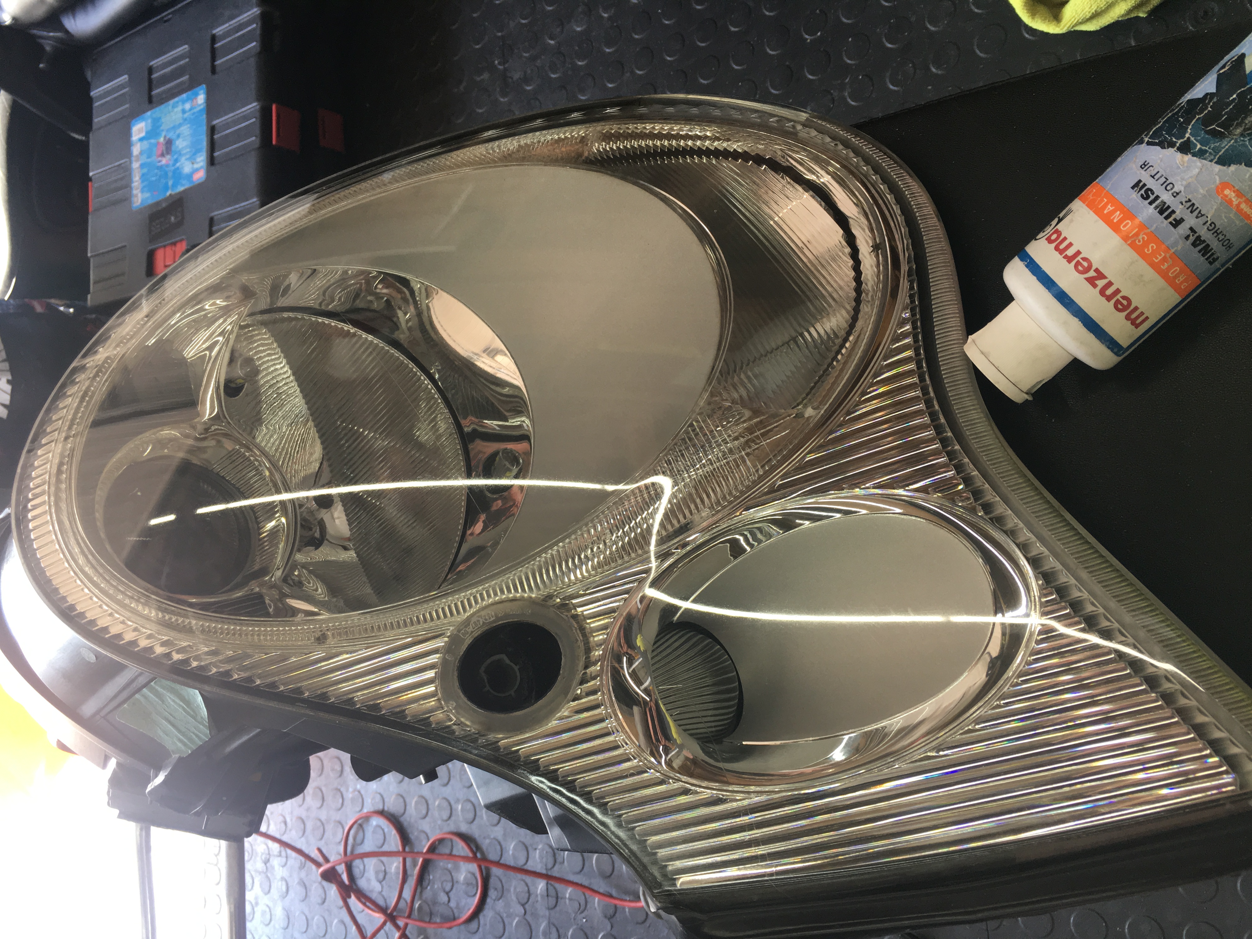

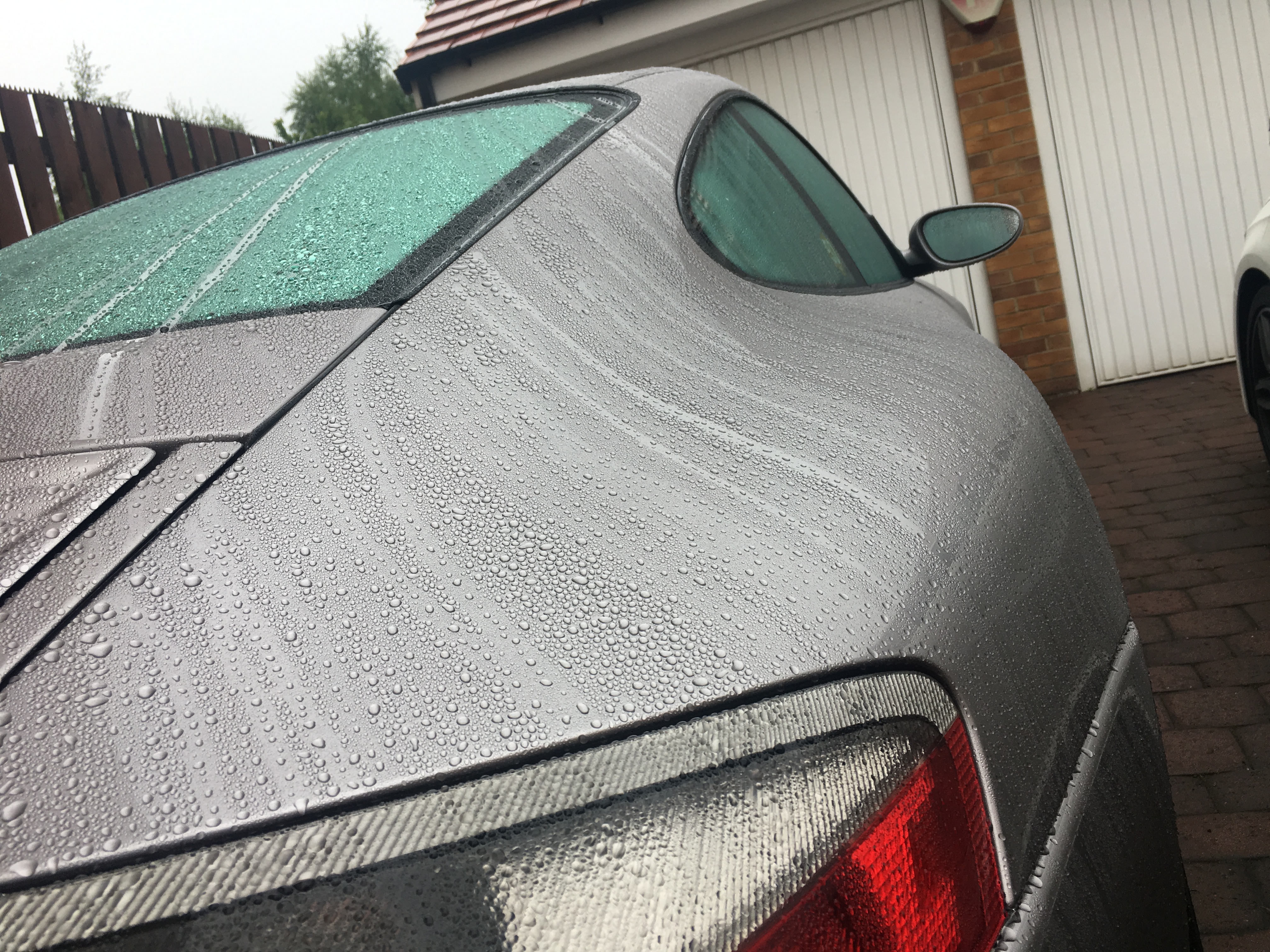

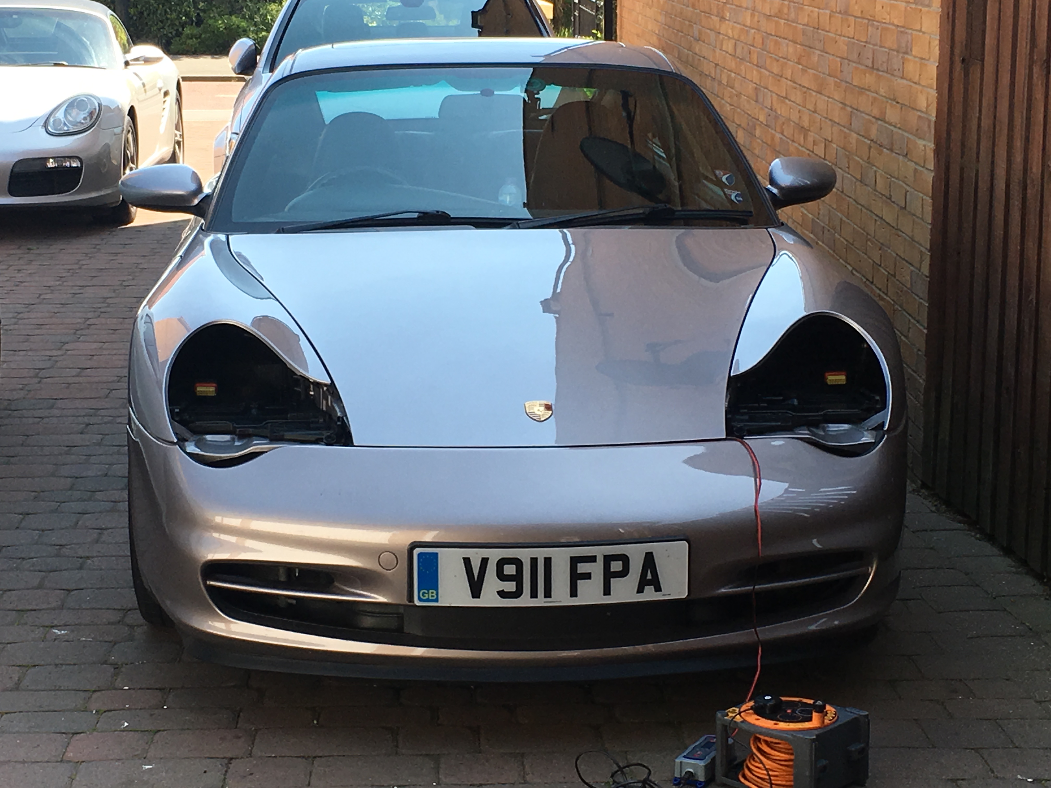

eldavo69 Posted May 22, 2018 Author Report Share Posted May 22, 2018 Also whipped the headlights out (looks drastic, takes about 30secs each side) and gave them a light polish with some AG glass polish and Menzerna Final Finish - not bad for 90k miles and 16 years! Gave it a quick wipe over and polish with AG SRP then some Chemical Guys Wet Mirror Finish that I had lying about - seems to bead well. Needs a full machine polish and some Gtechniq but that can wait. Also added a rubber EZ-lip to the bottom of the front bumper the other week, looks good (in my eyes) and is obviously creating so much downforce I can park the car upside down now - these photo uploads, grrrr. 1 Link to comment Share on other sites More sharing options...
CarMad Posted May 22, 2018 Report Share Posted May 22, 2018 I've done both cars in Crystal Serum Light and EXO v3 after a good buff and its incredible. Water hardly even sits on the surface let alone bead, the car almost cleans itself its crazy how good it is, highly recommended if applied and worked properly. 1 Link to comment Share on other sites More sharing options...
