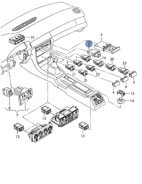

Ady_E Posted May 4, 2008 Report Share Posted May 4, 2008 Hi all I have attached a piccy from ETKA7 of the Hazard Warning Light Switch. It does contain the relay that causes the Hazard Lights and Indicators to flash. I too am currently experiencing intermittent problems with Indicators. My indicators come on but don't flash. I'm blaming a sticky relay cos when I thump the dash hard it works again! :D To think I actually get paid an extortionate amount of money for providing quality technical fault diagnosis and repair such as this! lol Joking aside, I'll have a look at the relay and see if a repair can be made or whether it's just easier to replace. Will get back to you. Regards Link to comment Share on other sites More sharing options...

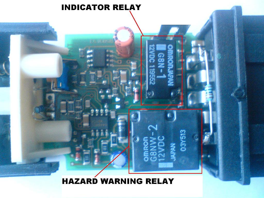

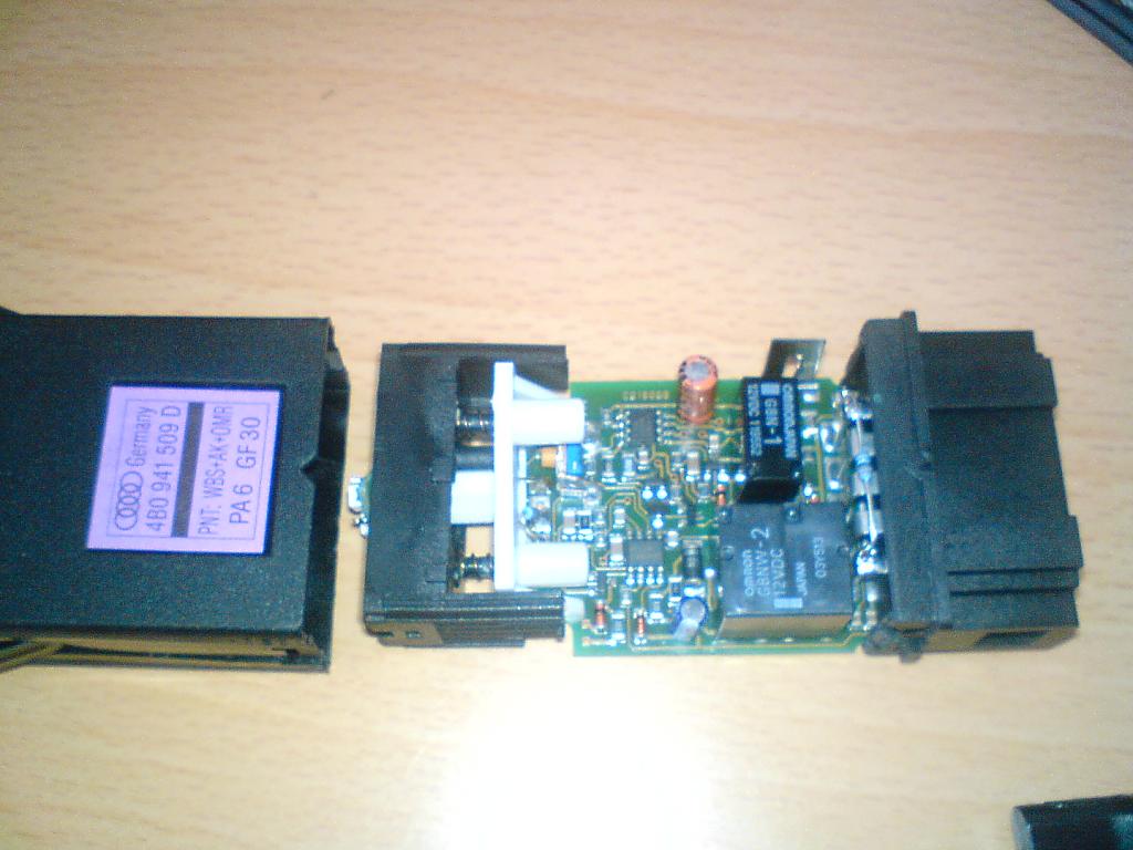

Ady_E Posted May 4, 2008 Report Share Posted May 4, 2008 Hi all Me again! I've removed the assembly from the dash. Simply pull off the facia then lever the switch unit out using a screwdriver. Go in from the top. Pull unit out and unplug harness. For an A6 C5 the part number is 4B0 941 509 D. Inside the unit (see attached pics) there are two relays the larger one controls the lights in the 'Hazard Warning' mode whilst the smaller one is used when switching the indicators left or right. This is the reason why Hazard Warning Lights still work when indicators do not. It's this smaller relay, a Omron G8N-1, that is sticking and causing the Indicators not to flash. If you're feeling brave or you know someone who can solder/desolder double sided though board components, the relay can be changed at a fraction of the cost of replacing the whole assembly. (better for the environment too!) RS used to stock this relay for around £5 but it is now obsolete. They have an 'alternative' but it is different and would therefore not fit in the circuit board. Maplin was a waste of time too. I have contacted Omson themselves asking where these relays can be bought but I'm not expecting a reply. I'll keep at it and post any developments on obtaining the relays. After all £5 is better than what Audi would charge for a new switch unit! I hate to think how much that would be! Link to comment Share on other sites More sharing options...

audidub Posted July 1, 2008 Report Share Posted July 1, 2008 Does anyone know if the G8N-1S would do? it is still available. It is listed as a "low voltage" version but has appx the same characteristics apart from coil resistance of 180 Ohm against 225 Ohm and a pull voltage of 6.5V as against 7.2V. An alternative looks like the CIT A16. ref Electronic Components: PCB Overview and www.citswitch.com/Relay%20Cross%20Reference.pdf Cheers, Michael. Link to comment Share on other sites More sharing options...
Ady_E Posted July 1, 2008 Report Share Posted July 1, 2008 I searched the internet high and low. There were plenty of people offering the relay as long as I was willing to buy a thousand at a time! :s Easier just to swap out the Hazard Warning Light Switch. Mind you since giving the relay a tap with the handle end of a screwdriver, I haven't had any problems! :D Link to comment Share on other sites More sharing options...
audidub Posted July 3, 2008 Report Share Posted July 3, 2008 I think you're probably right. Even thought he nice folk at Omron sent one gratis, it may be less grief to spend £15/€30 on the full kit. I'll try the mechanical response first though, since a thump of the dashboard gets it going again. Link to comment Share on other sites More sharing options...
Ady_E Posted July 7, 2008 Report Share Posted July 7, 2008 Never had a problem since! Link to comment Share on other sites More sharing options...
